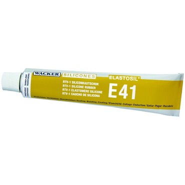

OK, 3M's VHB is a failure.
I am using the Natural Rubber Latex (NRL) as a hinge and the peeling forces are too great for it.
RECAP
- I don't want to use Superglue (/CyanoAcrylate) type glues as they are too aggressive and any surplus instantly messes up the surface of the NRL.
I would love to find a new "general purpose" adhesive that:
- Sets properly (must at least be "fingernail proof" )
- Once set it remains highly bendable & flexible
- Can bond well to rubber and most plastics (e.g. PS/ABS... maybe Nylon too??)
- Can bonds "most things to most things" (including woods and metals)
- Allows at least few minutes of repositioning time (no instantaneous grab)
- Isn't too aggressive (e.g. doesn't immediately denature rubber)
And as a bonus, if possible it:
- Doesn't need to be mixed
- Is clear
e.g. Have any of you folks tried:
A. Unibond Repair Extreme (now Henkel)
B. Dowsil 732 ("Multi-Purpose Silicone Sealant" )
C. Elastosil E41 from Wacker ("Moisture Curing Silicone Rubber" )
D. Loctite Plastic Bonder (2 part epoxy, designed for plastics)
Or do you have any other suggestions/personal favourite "general purpose" glues that might work?
Many thanks
J
