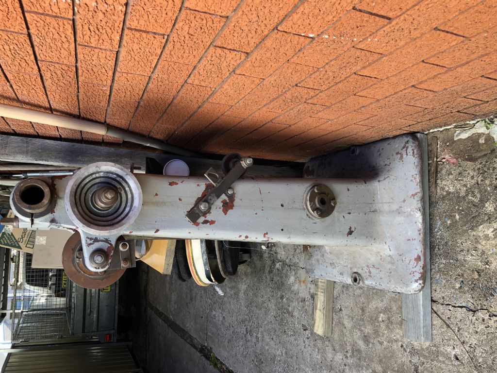

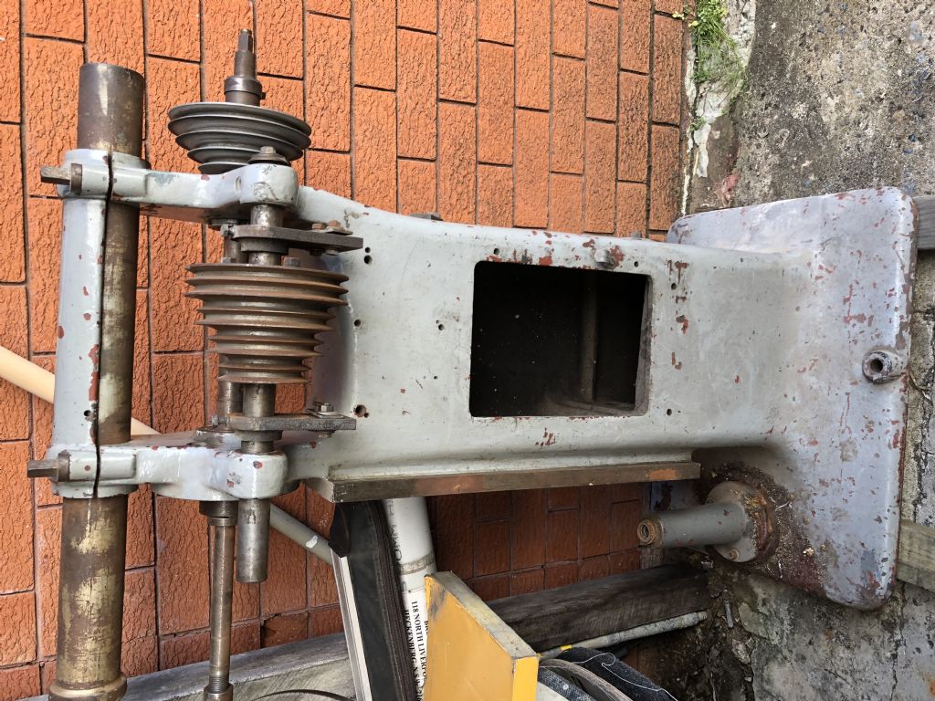

img_1590.jpgimg_1585.jpgGreetings from a new member over here in Australia. I am hoping the collective knowledge on this site can help me identify an old milling machine I want to restore.
I have tried forums her and in the US with not much luck. I have also thoroughly looked at vintage machinery and lathes UK but no luck. This is getting harder than I thought.
I will attempt to load some photos and see what happens.
Any help would be greatly appreciated.

Thiel ? certainly older than anything I have used.

Has some simliarites to a Pallas mill but I think this one is a little larger and the Pallas has a seperate countershaft. May be from the same family though.

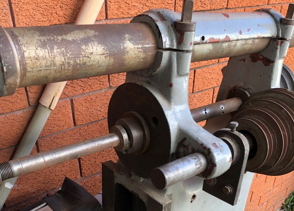

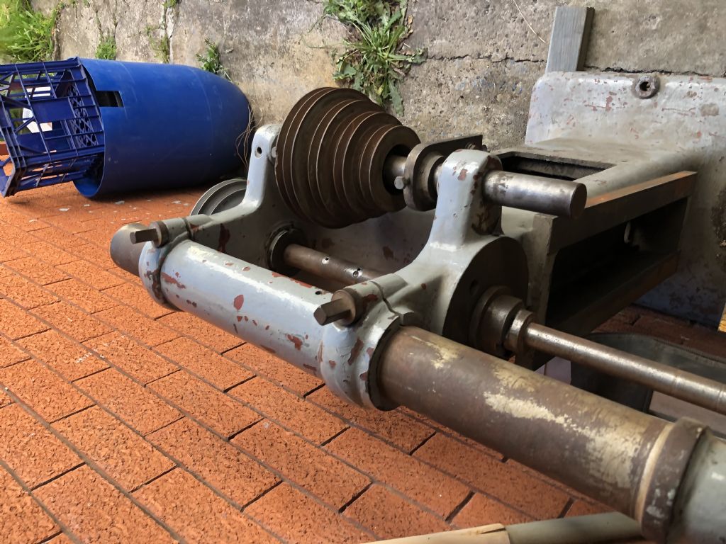

The one piece half circle casting clamping the round overarm down to the two separate support standards is unusual and, probably, a unique identifier.
However it is in general design a very generic small, lighter duty horizontal mill for its era. Quite possibly never marketed under a manufacturer name being supplied direct to large tool merchants and machine resellers who would have their own branding applied. Possibly via a bespoke door casting to cover the hole in the side of the plinth.
When new it would most likely have been flat belt drive via lineshaft. The multi step Vee pulleys will be later additions indicating that its been modified at least once in its (long) life.
Clive

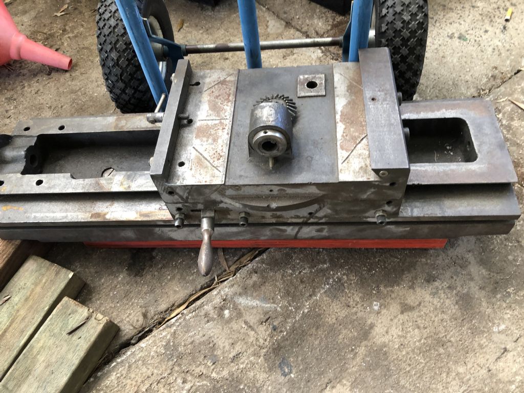

And it is a universal from what I can see of the table so that reduces the options from cheap hobby to small production machine. The release leaver for the table is perhaps unusual.

I would start with threads. Metric, imperial (UNC or Whit).
If imperial, check the 1/2 inch bolts/set screws as they will be different tpi.
The motor may even be original and offer some clue (frequency, voltage, power, method of wiring).
Dimensions of parts - support bar, shafts, pulleys, for instance. Bolt hole separation for the base. May be others.
All useful for a guess as to origin, even if there is no manufacturer’s name.

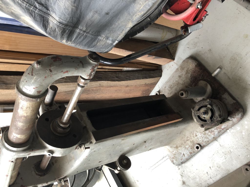

Heres a few more pictures.

Also the H-series were not universal mills - or at any rate, those on the lathes site are not; and nor is mine.
That peculiar drop-bracket and the side countershaft do not tally with Tony Griffith's archive photos although my own version has some differences from them too.

Thanks again for all the information. All those machines are close but still there are distinctive differences. I was wondering if anyone has seen a base like mine with only two holes that have a small raised section around each on another machine? Lathe, tool grinder etc. It could be an indication of a manufacturer.
Nigel I will have a look at shafts and fixtures tomorrow and take some pictures. What do you mean by drop bracket? Forgive all my questions but not quite familiar with this type of machine.

Base: the holes, with bosses to give proper flat surfaces for the fasteners, are of course for bolting the machine to the workshop floor, but just two like that is very unusual - I would expect 4, one in each corner, on any make of machine. (As mine has. I used self-tapping concrete-screws with big washers to secure it.) Perhaps they had "value engineers" even in the 1930s!
I see the column for the elevating-screw is held with socket-head screws. they bain't be from round 'ere! Maybe someone lost the original hex-headed set-screws at some point in the mill's life, and it's possible the holes have been re-tapped or fitted with thread inserts.
"Drop bracket" - at least that's what I've always known it as
Start with the over-arm, to set the terms' context. That is the long bar or tube clamped right along the top of the machine, adjustable for projection.
The "drop-bracket" is the fitting on the over-arm's outer end, that carries a bearing (usually a plain bush) concentric with the spindle, to support the outer end of the bar that carries the cutter. The arrangement is somewhat similar to using a boring-bar between centres on a lathe.
On your milling-machine then, it is the rather elegant curved casting that makes me think of a musical instrument! These fittings are usually a more functional polygon though on the original H-series it was a rounded casting like a figure-of-eight in profile. Your 4th photo down shows it all assembled except for a cutter, and though hard to tell it looks as if the cutter spacers are all on the cutter bar itself.
The spacers give you two possibilities: mounting a cutter at an appropriate, approximate distance along the bar, and to give an accurate gap between two ("ganged" cutters, for. e.g. making T-nuts, or end-squares/hexagons on the end of cylindrical work.
