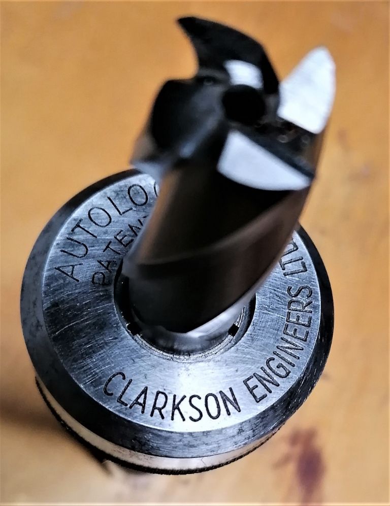

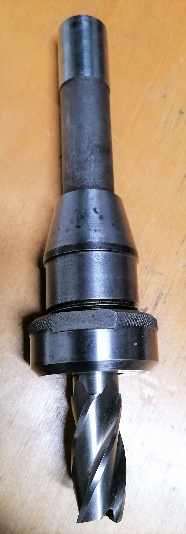

Stan Tomson18/10/2021 20:11:03
4 forum posts
2 photos
Hello Members,
Great news. After all these years ( at least 30 ) since I purchased the mill, I managed to contact the seller. He found the missing auto lock which was stowed away in his loft. Although he did previously say that it had been sold but the purchaser never turned up. He sent it to me with some C type collets f.o.c. What a relief..... Better that winning the postcode lottery.
I have attached a couple of pictures.
Thank you all for your input, very much appreciated.
