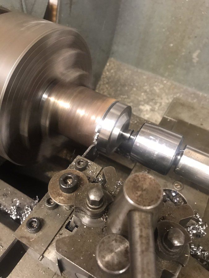

Dave S15/06/2021 21:42:39
433 forum posts
95 photos
I use centre support all the time on the CVA.
This is mystery steel, about 2" diameter:
Just remember to loosen it of as you get towards the actual cut off.
