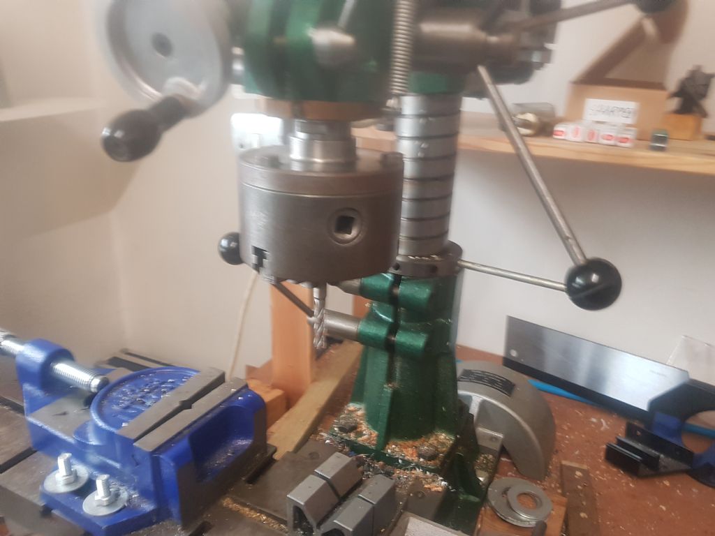

Im a bit afraid to ask this question as Im not well school on vertical mills But my DW is a treasure possession and when I asked about end mill and mentioned a 1/2 jacobs chuck I was suitable chastised by 100 lashes of a rhino whip and told to get a proper set of er 25 collets £120
I noticed I had a Myford thread on the spindle and as I had bought and eventually fitted a new 125mm chuck - bit of grief there reported alsewhere Myford nose job.
I now had a repurposed 4" Burnard chuck properly screwed up tight to the DW spindle.
As I had not seen any other references to using a chuck on a mill this way I thought I must be committing some kind of awful sin here
In my simple way it seems to work fine, but I never had any formal training on a mill
Any advice on my usage here
Tony Pratt 113/08/2021 12:31:17
2319 forum posts
13 photos
It's not something I would do as the cutter is likely not to run true & may work it's way out of the 3 jaw chuck under cutting conditions? Having said that if you are happy go for it.
Tony
brian jones 1113/08/2021 12:42:32

I should say that although my chuck is 70 yrs old it is in good condition and seems to run true enough for my needs
But your point was strongly made about the jacobs chuck - and quite rightly so.
Maybe I should use a chuck stop (spider) so the end mill cant slip inwards
Its certainly something i shall bear in mind only serious use will show up the deficiencies

Hardened Jaws don't grip end mills very well, you could maybe try soft Jaws, but still a bad idea in my opinion.

It's often more a case of the cutter pulling out of the chuck rather than riding up into it particularly if using a lot of the side of the cutter as the helix pulls it down. Although true the jaws may still have worn over 70yrs and become slightly "bellmouthed" so won't grip well along their whole length.
I've done it a couple of times in the past when milling on the lathe but would not do it now that I'm wiser as I have better ways to hold cutters.

OK JB I hadnt thought of bell mouth
I will check on this
I presumably could re grind the jaws in situ, or maybe use a Covid cutter to skim out the jaws parallel (i realise this is not as easy as it sounds)
"helix pulling the cutter out"
I hadnt thought of that, it would explain why i ended up with a deeper cut than when I started on one job
