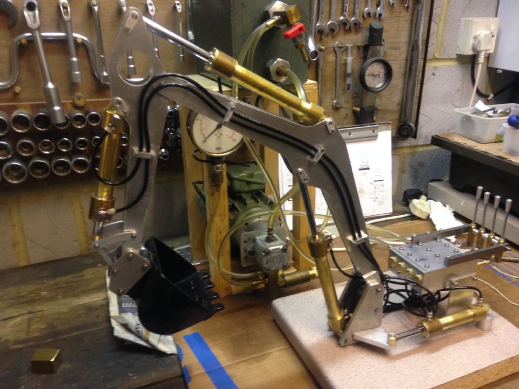

excavator arm.jpgI thought members may be interested in my completed excavator arm, something I have wanted to build since being a small boy.
I have scaled it from a die cast Kubota model I have and it was never my intention to make a replica model, just somethig that looked OK and I could play with. At the moment I am running it at a 100 psi at which it seems to have more than enough force. During some early experiments I used up to 150 psi and apart from a few tubes blowing off it held together.
My main concern was that the 4mm tubes used would be so restrictive as to make the speed of operation too slow but it is OK and 'to scale'.
Going to get some cat litter so I can have a play.

BEAUTIFUL, it will give hours of fun, Lego did a 360 tracked digger some years ago that worked by pneumatics. Small hand powered hydraulic systems often work at 10,000psi. Noel.

Very nice indeed, have you thought of going the whole hog and making the rest with working tracks and dozer blade which many had fitted
