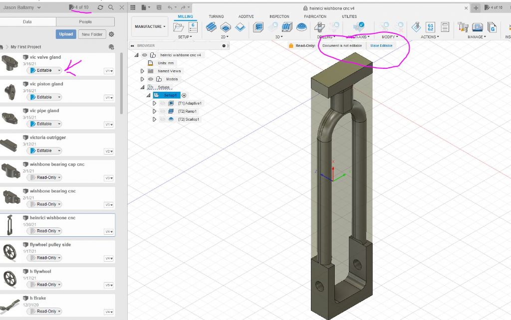

Having not used my Fusion 360 account for a while due to work commitments
it became out of date ? I was requested to update to the latest version which I did. All seems well and I now have an up to date personal account with access to all my previous designs and learning samples.
I have a previous design already drawn in cad and have the cam also complete from a while ago, however I now realise that I need to edit the design slightly.
Fusion 360 now shows my CAD design as read only and will not allow me to edit. Is this standard for the latest version or have I done something wrong.
Fusion keeps leading me to the prices page and so I am assuming it is a restriction they have introduced. Can anyone advise please as my only other option as I see it is to redraw my original design from scratch hopefully with no mistakes.

If you open the Model and EXPORT a stp file to your computer and save under another name then IMPORT new named stp file it may show the original sketches, if not with the model loaded you can generate any number of new drawings from the model.

The free subscription to Fusion now has a limit of 10 editable files at any time.
If you reach the limit of 10, then you have to make at least one of them read only to edit an earlier one. Do this from the data panel
This is mildly annoying, but is only really going to cause problems if you insist on having each component as a separate file.

Click the icon at the far top left which is a group of squares, this will open all your projects and show which are read only and which are editable, just change them around so you can edit the one you want.
NOTE that if you use features that are no longer accessable in the free version such as "steep & shallow" you won't be able to edit those and you will also have to split the code up for each tool if you had cone the CAM with more than one.
Not good to export and reimport as that only brings the part back and you have to do the CAM all over again.

Well, Ive tried to change things but to no avail.
I get the error message " READ ONLY YOU HAVE BASIC ACCESS TO THIS DOCUMENT.
I followed your advice Jason and also similar from the internet.
My editable folder is empty and my documents do not show the switcher which allows me to change from read only to editable.
Any suggestions anybody ?

If you can open the document there is also an option to make it readable, ringed in pink. You can also see the tab below each file where it can be switched and the 4 out of 10 files I have set as editable.
If all else fails turn off computer and restart incase F360 needs a reboot.
