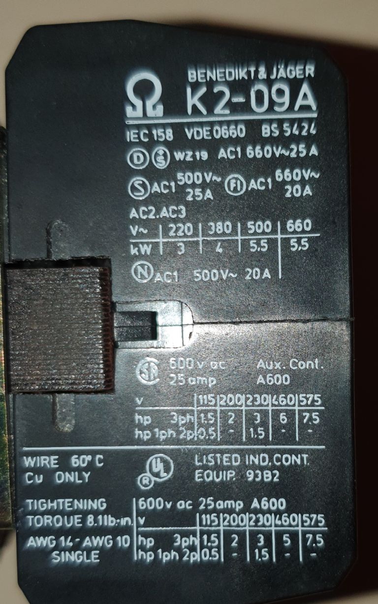

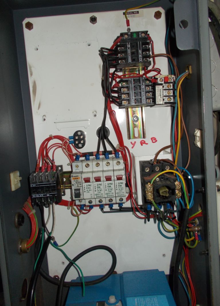

The mill is wired as it came from the dealer and has not been altered by myself. It has however worked perfectly for the last five years or so. The spindle still works fine it is just the 2 off power feed units which now show as having no power ie no green light on the units. These are both powered by a separate 110V transformer.
I have tonight removed the contactor and to my untrained eye the coil appears to be damaged / burnt. Luckily all the information on the unit is still readable if I need to replace with similar from somewhere / somehow. I wouldn't know where to start looking.
I have added photos of the contactor and overall wiring which will hopefully make sense to somebody a lot smarter than me.
I don't have a wiring diagram.
Thankyou to all that have replied with advice and information, it is very gratefully received.20211012_193552.jpgdscn2548.jpg20211012_193939.jpg
11/10/2021 08:29:22
Thanks very much for the help.
I will take the contactor off and get the details from it. For the prise of a new one I will swap it over and hopefully be back in action.

Hi Guys
I am very hopeful somebody out there can offer me some advice regarding my power feed. The feed is on my Bridgeport mill. The mill is 3 phase and I run it through a Jaguar Inverter. The power feed side runs on 110V I power the mill through the inverter and everything still works fine Spindle etc.
I was using the power feed on a job taking medium cuts and all was fine with no issues. I then went to proceed with another cut and nothing ! I wasn't using the power feed to the Y axis but this also now has no power.
Opening the Mains power box shows the ( MCB ) ? has tripped. I can reset this and it remains set but still no power. Looking at the contactor to the left hand side it appears seized . The other contractors allow movement of the part circled in the photo ie spring back when pushed ( Not whilst plugged in I may add ) I don't mess in there under power. I can also see and hear the other contactor move when the on switch of the mill is pressed. The power feed contactor does nothing and as I say appears solid. Is it likely that the contactor is the problem or am I just being very hopeful.
I have found the same contactor on line or at least one looking identical with the same code K2-A9 A10. Am I to assume if this if required it will be the same voltage etc. Or will there be variants of this. I am NO electrician.
There are no in line fuses that I can see. I have an old identical power feed which was removed as it has a damaged gear inside but still worked under power. This has no power either and so I am assuming it isn't a power feed unit fault, Also both axis now no longer work.
Very long winded I know but any help or advice would be very much appreciated.
