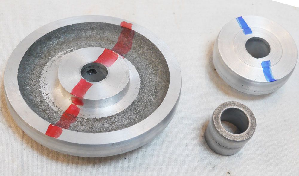

I have an Alfred Herbert Model B high-speed drill, and as-made it should have come with three interchangeable motor pulleys. These are secured by a LH thread stud onto a tapered shaft on the end of the (single phase) motor. When I bought mine it only had the smallest pulley - giving the slowest spindle speeds.
The pulley on the spindle is two-step, as should the interchangeable pulleys be. I calculated what diameter motor pulley was needed to give the intermediate and high speeds - I didn't bother with two-step - and turned them from multi-step aluminium pulleys, as used for pillar drills and the like. I put a crown on the pulleys to make sure the belt stayed on-centre.

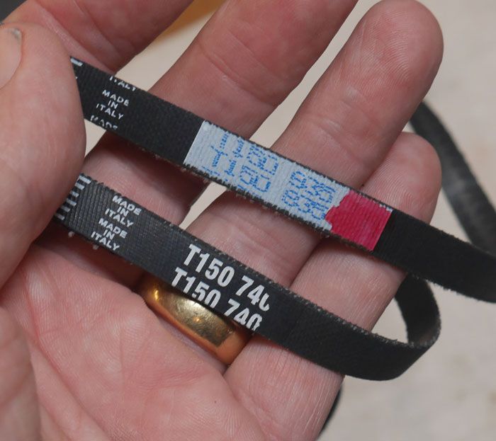

The other issue is one of belts: you need a different length belt for each pulley - there's insufficient adjustment on the motor to allow for changing the pulleys. I got my belts from a very good company in Gloucestershire - can't remember the name I'm afraid, but they were no huge problem, and I bought two of each size, which will see me out! If you would like photos just shout.

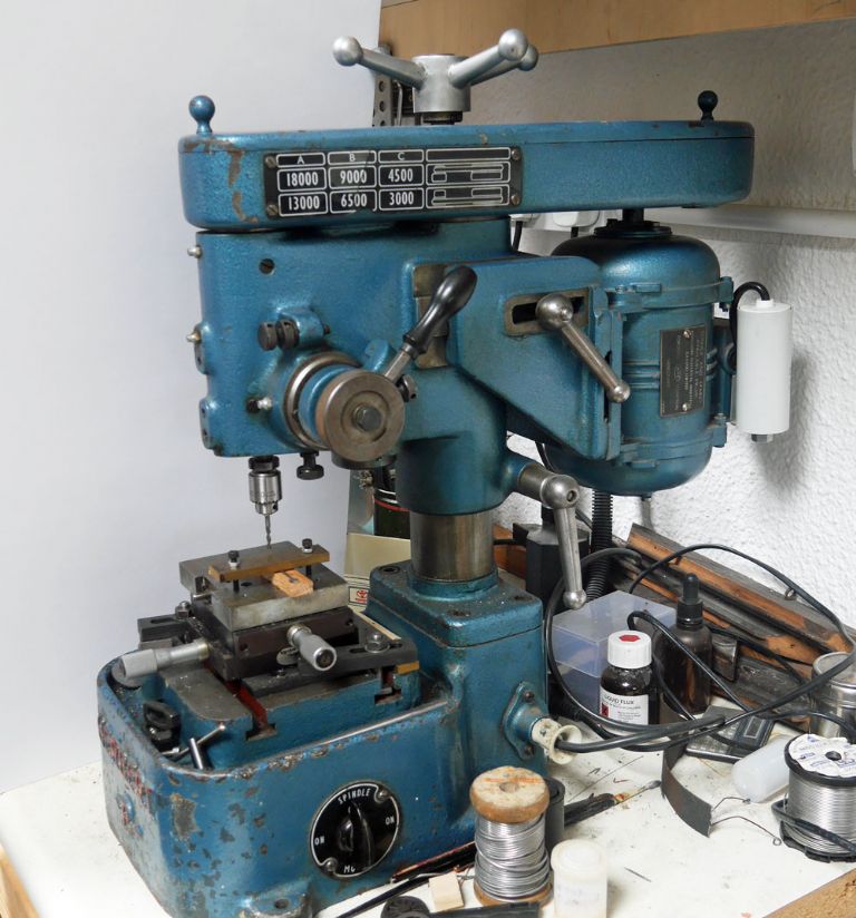

Hi Andrew
On the basis that a photo is worth a thousand words, I've uploaded some pics of my machine, which I suspect is smaller than yours (!). herbert1.jpg

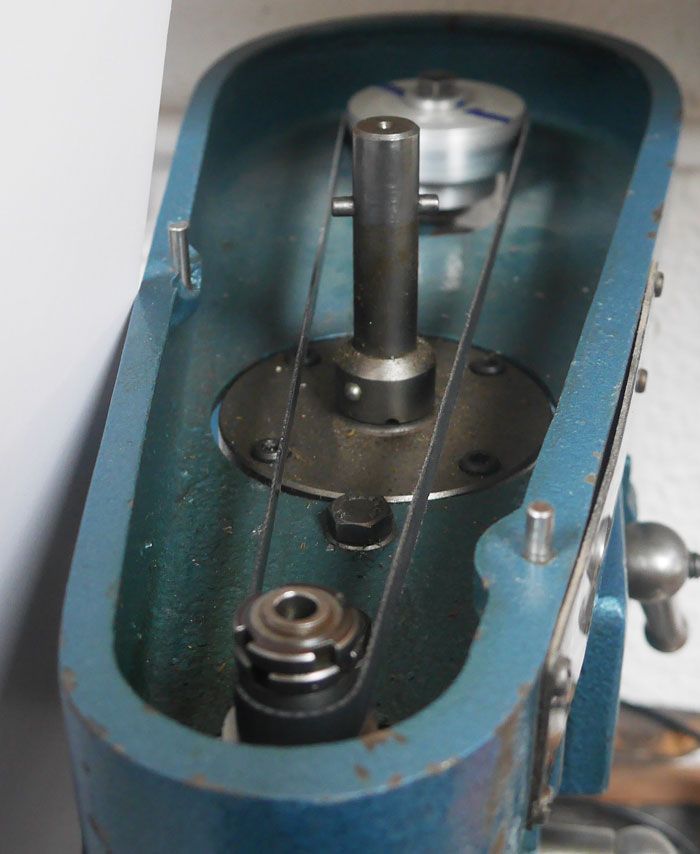

next pic is with the cover off, and shows my home-made second size pulley in place on the motor spindle (the tall central spindle is the rise and fall mechanism for the head casting on the pillar).

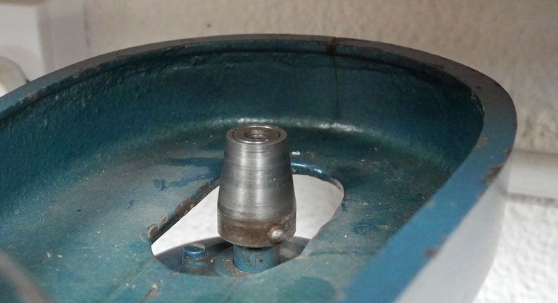

This shows the taper stub on the end of the motor shaft, onto which the chosen pulley is bolted...

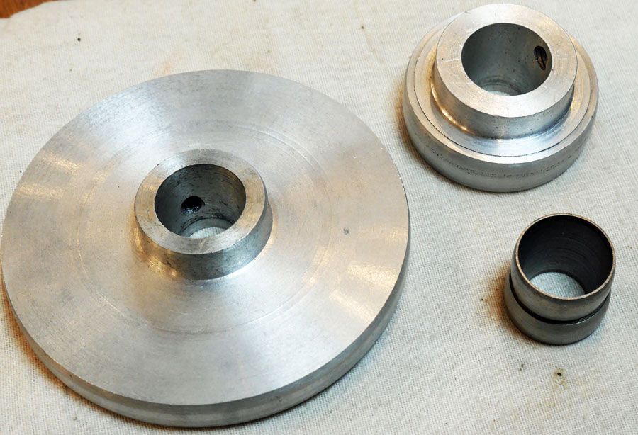

...and these are the three pulleys. Original cast-iron bottom right has two options, whereas my home-made aluminium ones only have a single step option.Turned the internal taper on my Emco Maximat V10P.
The other side of the three - the large one betrays its origin as a multistep pulley!
Lastly two of the three belts. These are the medium (740mm) and long (835mm) belts. Any decent belting/bearing supplier should be able to source them for you. My belts are significantly smaller cross-section than yours - 10mm wide by 1.1mm thick, but the same principles would seem to apply. My machine came into my old shop - The Tool Box in Colyton - some years back, and I had promised myself a high-speed drill if one ever came in: I model 0-gauge railways, and for drilling small-diameter holes (down to 0.35mm or so) it is incomparable.
