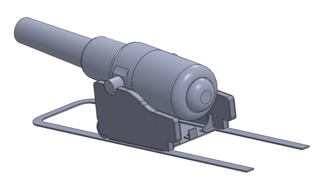

I thought I would start a thread on the latest piece of artillery I am hoping to model. Progress will be a bit slow I'm afraid as I have quite a few distractions at the moment, however I'm hoping that putting this on here will encourage me to pull my finger out and get on.
For any enthusiasts it will actually be a Mark 4 barrel. The carriage will be a Garrison Casemate or Dwarf sat on top of a Dwarf A Pivot Slide. Its going to be about 1:12 scale so the barrel will be about 12" long as that is about as large as I can handle in my lathe.
At the moment I am slowly producing a CAD model of it so I can get a few bits cut such as the carriage side plates.
I hope at least one of you might find this interesting. Thanks.
gun carriage assembly

I've also got a photo of a gun in New Zealand which claims to be a mark 4 but it could I suppose be the similar looking 2. Anyway here's the progress so far.

Quick update, I have made a bit more progress on the slide. I thought there wasn't many bits in one of these but that was a mistake.

Well I managed to make a bit more progress on the Cannon, mainly rivet holes.
