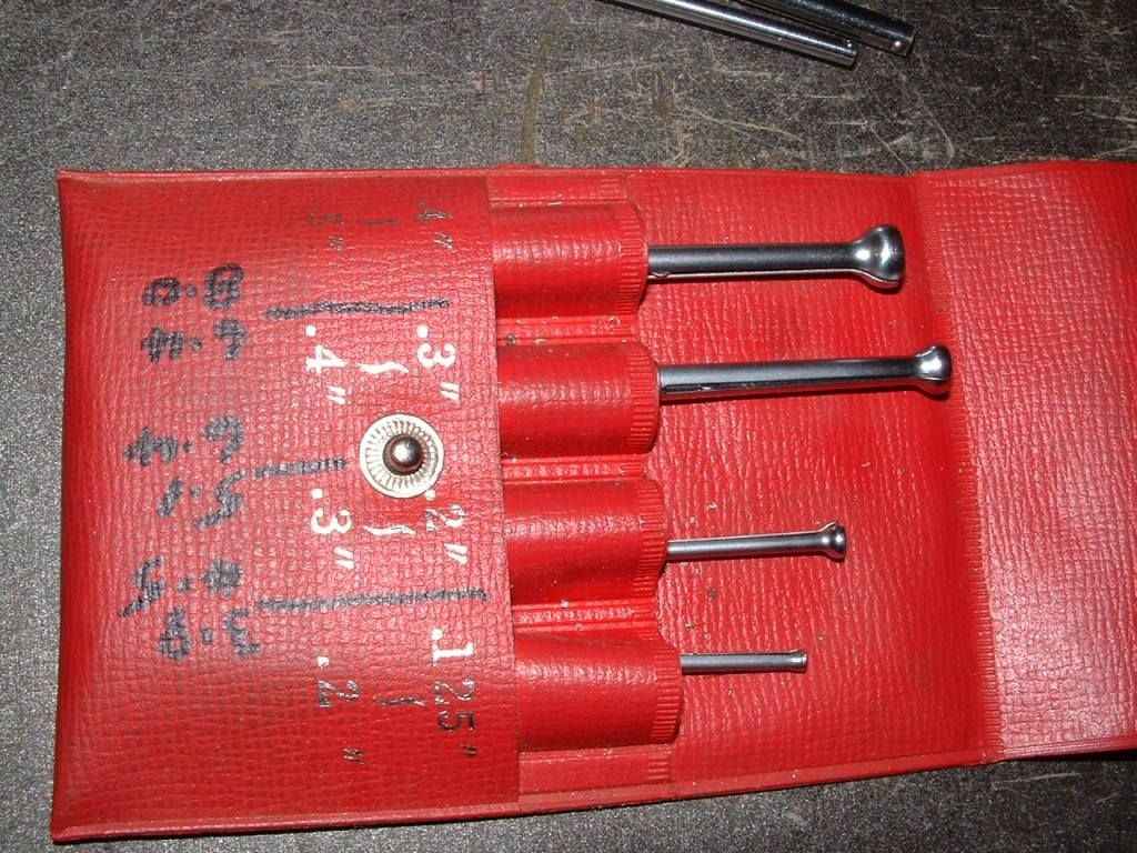

I’m currently building a rc Scania truck chassis. I’m using pretty small bearings. From 4 mm to 10 mm outside diameter. I’m struggling to decide what’s the best way to measure the bores to fit the bearings properly. At the minute I’m using a cheap inside jaw micrometer I got of eBay and calibrating it with my Mitutoyo Digimatic QuantuMike outside micrometer. Still sometimes I end up with the bore slightly too big and the bearing fit is loose.
I’ve been debating with myself for weeks about the best way to measure the bores. Do I stick with the inside jaw micrometer but get a decent make or do I go with a 3 point inside micrometer, again of a decent make.

You could make some plug-gauges: an o.d. is a lot easier to measure accurately..
Turn spigots on each end of short lengths of mild-steel bar; one end a known fraction under-size; the other to size appropriate for the bearing. Mark the rod with which end is which.
Aim for the under-diameter plug just entering, first.
You may well find the spring-cut on a boring-tool will bring the hole to size, even a touch over, quicker than you think.

Darren
I use these on small bores, fit the gauge in the bore and then measure over the gauge with a micrometer.
You may have to turn a stub piece to the finish size needed for checking as you make the shaft.
The top set are split and the bottom set have 2 balls to measure over.
As with all gauges of this type you will develop a feel for them the more you use them.

Thank you everyone for the lard amount of responses. I'm still tempted to splash out on a set of 3 point micrometers. Just really cant justify the amount it would cost for the Mitutoyo sets, although I know they would be really nice to use and last a lifetime.
I have a cheap set of the expanding gauges, eBay again, but find them extremely difficult to get the diameter just right. I think its because of the hand surgery I got 3 years ago. Severe Carpel Tunnel Syndrome. The surgeon did warn me that the damage was already done just because of the length of time I was on the NHS waiting list before I got my operation, but that's another story. Since then I find my dexterity isn't what it use to be and I had to give up my miniature model figures painting, as I just don't have the fine control I once did. I always find I either over tighten the expanding gauge or not tight enough. This makes repeatability difficult. That's why I've been looking at micrometers with their ratchet thimble ensuring consistent tightening force.
The dial bore gauge looks interesting. I didn't know they could be got for use in such small diameters. I think I'll look at either turning gauge plugs or getting a few pin gauges plus and minus the bore diameter I'm making at the time and see how I like using that method. I'll also keep an eye out on MSC to see if they have the bore micrometers on offer again.
