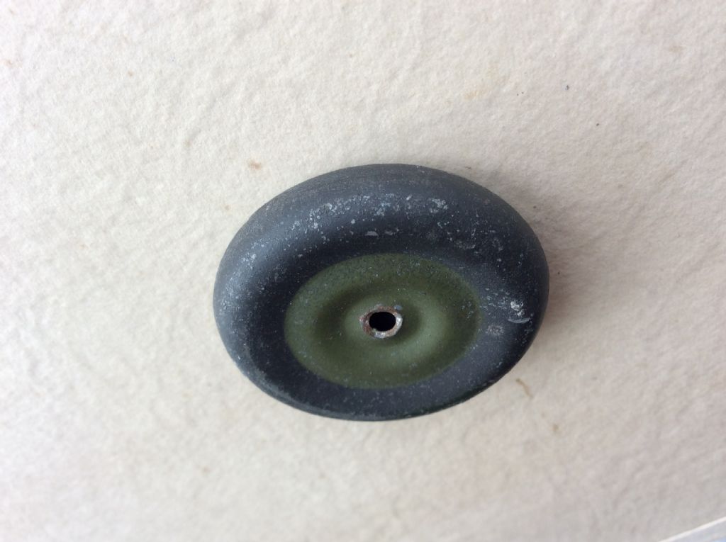

4a1c2a05-4400-45a1-acbd-5ca72bc7069e.jpegHi All,
I’ve started the refurbishment of a 1:14 scale WW2 era model jeep, the most pressing issue is the absence of wheels. Attached is a photo of the spare wheel, which is hollow so I assume is pressed from sheet steel. OD is 40mm, “tyre” width is 10mm. Any thoughts as to how I could make a wheel/tyre to visually match this? My only thought so far is to turn it from solid using a hand ground lathe tool to get the tyre profile, but that sounds challenging. Any suggestions would be appreciated.
Thanks, Philip.

If it is hollow it sounds to be two 'shell' pressings back to back. Is there any evidence of a seam down the centre of the tyre? If it is a pressing I would have thought a die to press the wheel/tyre halves would be quite doable. Depends what tools you have available.

Thanks to all for your suggestions, pressing from a Die and 3D printing were options that I hadn’t considered. I’m keen for the wheels to visually match the existing spare and haven’t yet found anything similar from a model supplier, but will continue looking. Making a press die is currently beyond my skill and equipment set, but would be a good solution. 3D printing could also work well, need to research this.

You could turn it from solid aluminium etc. easily enough. Use a ball turning tool to put the radius on the tire. (Jeeps have tires not tyres. laugh ) The shallow grooves on the side could be done with a ball turning tool with the tool poked forward of the pivot point to cut a concave surface instead of the usual convex.
Or you could as you say grind up some form tools. Probably one radius tool shaped in a quarter of a circle could be used to do one side of the tire then flip the blank over and do the other side. Then the grooves on the side could be done with a simple round-nosed form tool. c.
I think you would have it done in the lathe quicker than any other way unless you have a 3D printer already to go. Making dies would be good if you were going into mass production but probably not worth it for four wheels if you are not fussy about having original style pressed tin wheels etc and the solid aluminium would be ok.

Hand turn from wood or some kind of nylon/delrin/acetal what have you?
Or looks like it would lend itself to casting. Mould from plaster, silicon, plasticene, papier-mashe, gumstrip. Cast in resin or similar.

Matching the spare wheel exactly might prove awkward. Why not make five and be done with it? Like William above, I'd probably use black delrin and paint the wheel part afterwards. Maybe knurl the outside, too, for a "tread" effect? Then you would get a more realistic look. Unless that offends the "original" aesthetics. Don't think I've ever seen a Jeep with round section, bald, tires or tyres.

It's hard to see the scale of the wheel from the pictures but could the wheel be made in 2 parts?
The inner hub would be easy to turn from steel or cast iron and then painted. The tyre could be made from a thick o-ring.
OR
You could try "spinning" the wheel shape over a wooden form, Made in 2 parts from soft brass and then soldered together before painting.

Williams idea of resin casting is a good one so I may explore that further, but will initially make a form tool and try turning them up from aluminium bar. If they turn out well I’ll post a photo of the completed refurb.
