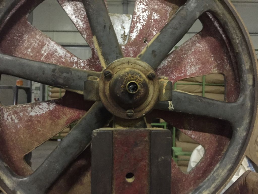

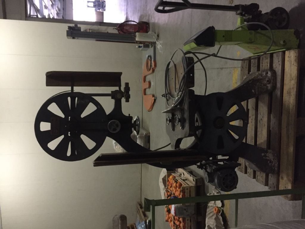

nipple2.jpgI have just bought an old Italian bandsaw, I have no idea of its age but the 3ph motor can be run in delta or star so not too old.
The grease 'nipples' consist of threaded tubes with threaded caps and I do not know how you apply grease to these under pressure.
One of the 'nipples is 16mm in diameter, the other 30mm.

Thank you. I have no idea what sort of bearings yet, just so long as they are not Babbitt. I have managed to add an image of the upper wheel, does this give any clues as to the type?

I would guess at bronze bearings because the wheels would not be revolving at high speed. I wonder if you remove the three slotted screws shown in the second picture, you may be able to see the end of the bearing to determine what kind of bearing it is? This would also give the opportunity to clear out some of the old grease in there.
