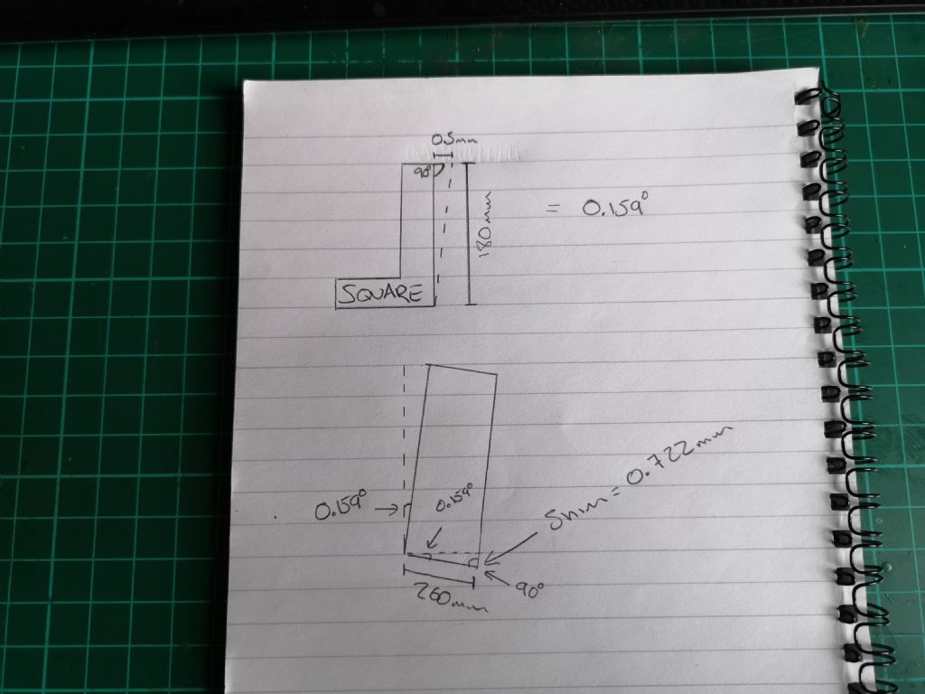

How does this look, from a back of a fag packet perspective?

Posted by Lee Jones 6 on 06/12/2020 13:10:28:
It's out by 0.5mm over 180mm????
Holy leaning tower of Pizza, Batman. That's bad, even for Chinese junk. One heck of a shim you need there at over 0.75mm.
You might want to double check everything and make sure. Then try to determine if it's the column or the machine base thats been machined wrong and think about getting it remachined by someone who knows how to use a square.
If your machine is still under warranty now is the time to contact the seller. If they swap you for another machine, check it to as these things tend to be done in batches all the same and it's not unheard of for the replacement to suffer the same problems as the original.

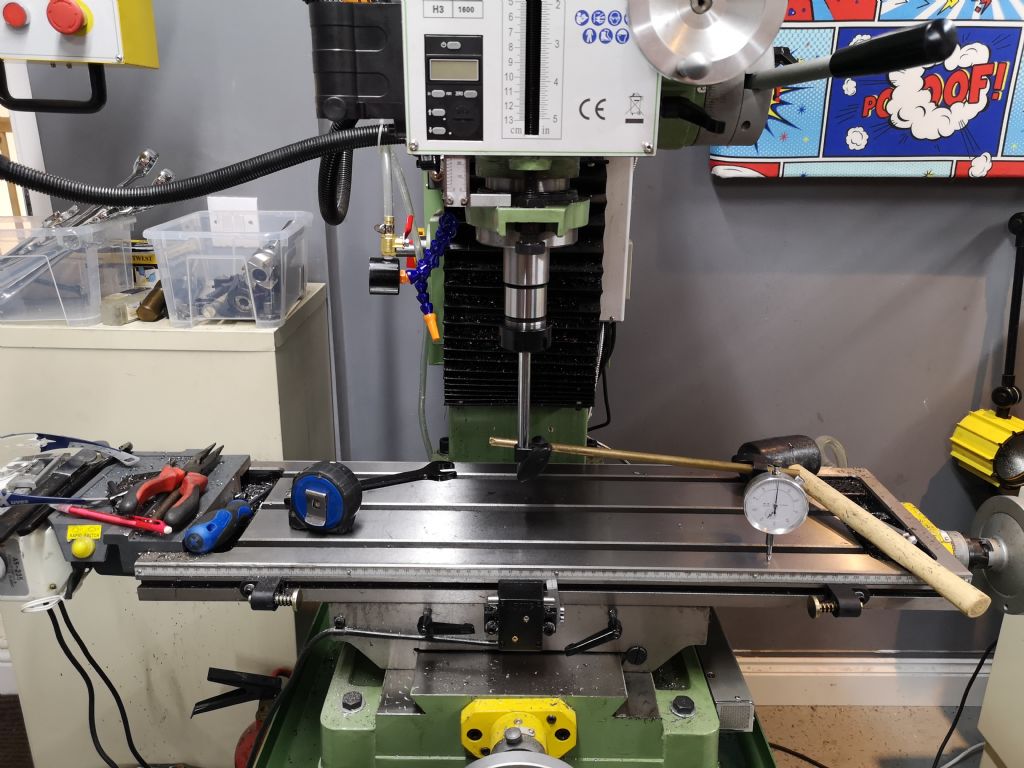

The 0.1mm result was using the long janky brass set-up:
After receiving the collet held indicator holder from Arc, I dialled it in a lot better.
This time I have it to probably <0.002mm.

I converted to degrees to obtain the shim stock thickness required. Not sure how to do that with ratios.
It's not currently possible to move the bolts at all with the tools I have. I've since ordered a large 12mm hex key.

Martin Connelly07/12/2020 09:25:51
avatar
2549 forum posts
235 photos
The formula is in the post above for shim stock thickness.
error x distance across shimmed distance / distance error was measured over = required shim thickness
0.5 x 260 / 180 = 0.722
