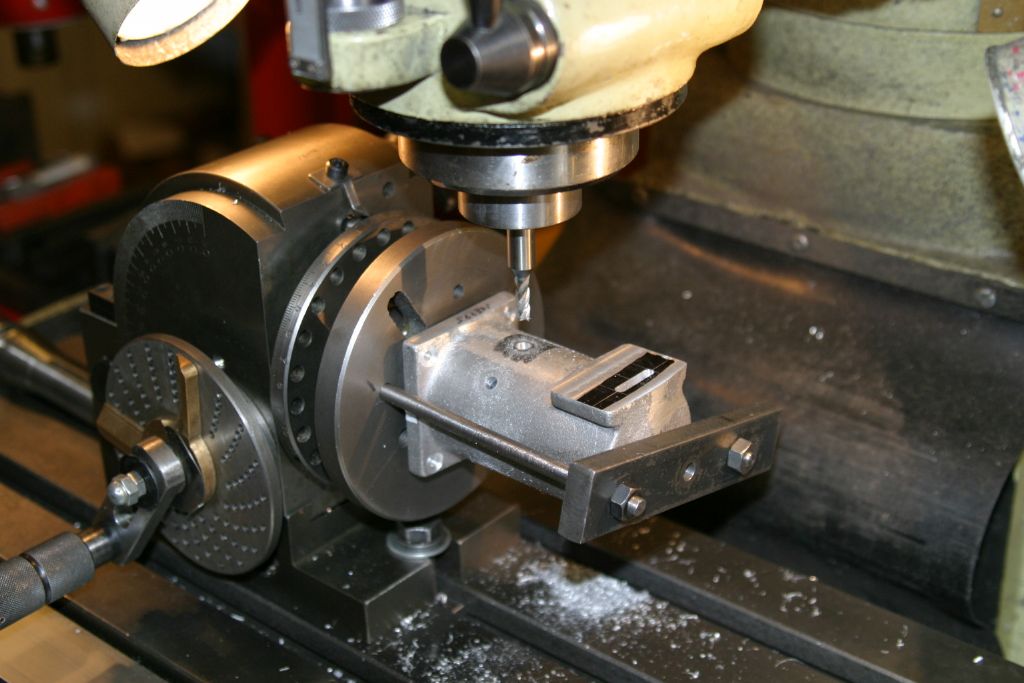

The next job was to hold the liner by the ends in the mill vice, and using an end mill, cut a .140 x .750" recess in the end to clear the steam admission slot in the cylinder jacket.
The cylinder exhaust ports are eight 3/16" holes equally spaced around the the cylinder 1.280" from the bottom.
To drill these, a locating ring was turned up to centralize the cylinder and liner on the dividing head.
The liner was slid into the cylinder, and ensuring the the recess it the top was lined up with the slot in the cylinder, it was clamped to the dividing head by a bar across the top. The exhaust ports were then made. First spotting the holes, then drilling .015" under-size and finishing by plunging through with a 3/16" end mill. Doing it this way I hoped to raise the minimum of a burr on the inside. Once done the liners were removed and a couple of minutes on the lap removed the small burrs that the drilling created. The lap was cleaned up and a further lapping with 500 grit finished the bores. Just left to do is to fasten the liners into the jackets with retaining compound.

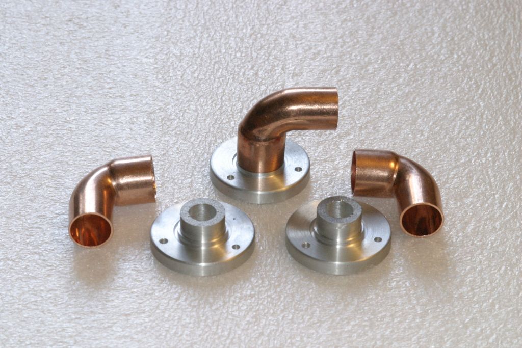

The valve bodies are aluminum castings very similar to the cylinder jackets except that they are smaller and open at the top. The first operation was to grip in the 4 jaw with the top flange outermost, truing as best as possible on the outer cast surface. The face of the flange was cleaned up to a flat surface to act as a datum for the next operation. It was then held in the mill vice with this face on the fixed jaw and with the face of the cylinder mounting flange set as horizontal as possible the mounting flange was milled to just clean up. It was then turned over, and with the mounting flange on a parallel the boss for the steam inlet was milled flat and to the same height as the top flange. The liners for the valve bodies are supplied as a ~6" length of nominal 1" diameter seamless hydraulic tubing. The tube was chucked in the 3 jaw and with the outer end supported by a rotating centre in the bore, the OD was skimmed to clean up, finishing at .990". The three liners were then cut off over length and the ends cleaned up.
With the body back in the 4 jaw, top flange next to the chuck, it was pressed back on to a parallel and trued as best as possible on the outer surface. It was then bored out to .992" for the liner. The liners were then fastened into the body with high strength retaining compound. I had hoped to true the bores of the liners up with just a short lapping as I did for the cylinders but no such luck, they were too far out of round.
So back to the 4 jaw to bore them out to true them up. When setting up in the 4 jaw they were trued using the bore, ensuring that they were as true as possible both radially and longitudinally. They were then each bored out to .882.
Set up on an expanding mandrel to skim the top flange to ensure it is at right angles to the bore. This flange will be used as the datum when finishing the mounting face to dimension, thus ensuring that it is parallel to the bore. Reversed on the mandrel, the bottom end was turned back to give an overall length of 1.750" as per the plan.
Back to the mill, setting the mounting face parallel to the table, to mill the face back to the plan dimension of .860" from the centre of the bore, ready for the next operation; cutting the .140" x .75" steam admission slot to mate with the one at the top of the cylinder.
Having first marked it out, the steam transfer slot was milled out with a long series 9/64" end mill. The same sequence of drilling and milling was used as for the cylinder jackets.
The valve body heads are simple castings requiring only lathe work to bring to dimension and then drilling for the fixing bolts and the exhaust port. Exhaust stubs are 1/2" copper plumbing 90 degree street ells.
Edited By John Purdy on 27/11/2020 05:13:10

Using the expanding mandrel on a "V" block to hold the valve body with the face vertical to mark out the mounting holes symmetrically around the bore centre line.
The valve bodies finished with the mounting holes drilled and counterbored, and the top flange tapped for the heads. The holes in the bosses for the steam inlet on the front still have to be drilled and tapped. Plans call for them to be 1/8" NTP, but I haven't decided what to use for the elbows, so till that is settled they will have to wait, along with the final lapping to remove any burrs from the slotting and drilling/tapping.
