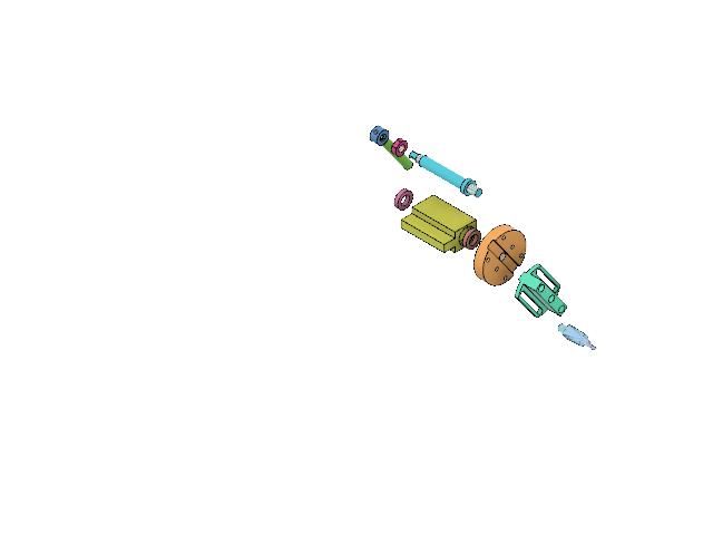

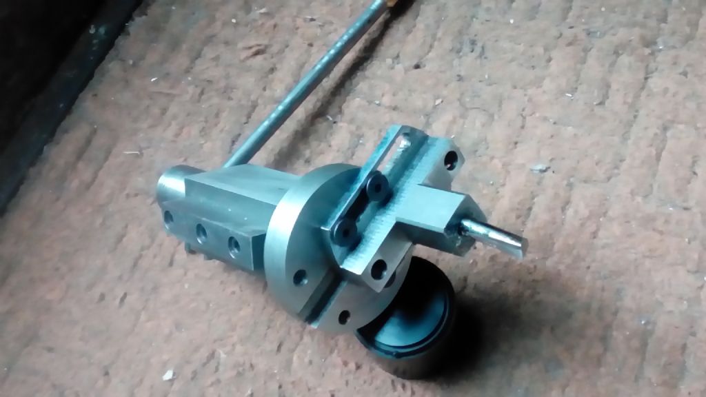

Nick Wheeler29/10/2020 12:20:30
1227 forum posts
101 photos
I bought the Hemingway kit just after getting the mill, and made a mess of everything I did.
This repurposed the shaft and shaft holder, plus a couple of other bits including the tool:
The head and slide are from 60mm bar, the slot is 10mm wide. Shaft rotates on cheap bearings, and is screwed and loctited to the head.
It's only ever likely to be used for decorative balls(gear knobs, handles etc) so I saw no need to complicate it with an adjuster mechanism
