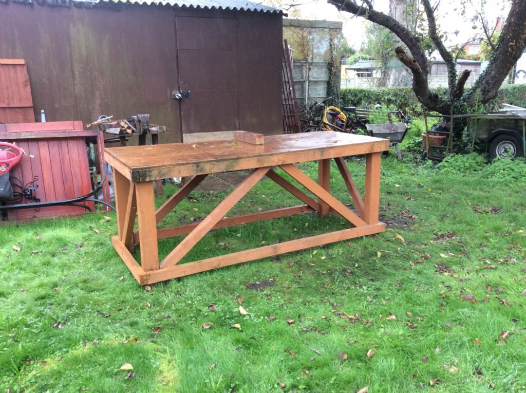

I would consider something like this ,this is my outside workbench . Very strong and cheap to make ,4 x 4 fence posts for legs and 18mm plywood top ,4inch screws to hold it together.
Maurice

img_20151108_141159657[1].jpgThis is what I made for my ML7,based on a design in MEW a few years ago.
Maurice
