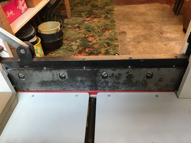

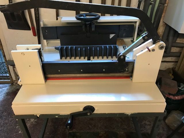

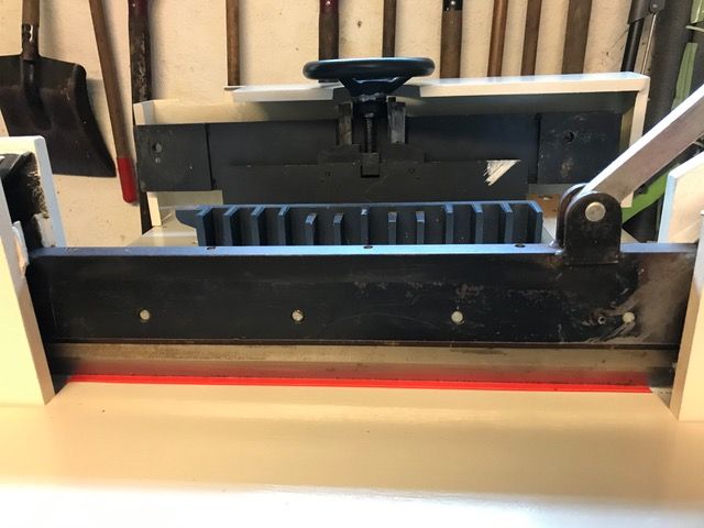

Greetings fellow forumites, I have a friend from the world of bookbinding who has the machine in the photographs- he believes it is an Ideal guillotine, made in Germany, and some few years old.
He wants to get the blade resharpened, it is 58cm long by 9cm deep, and presumably hardened.
He may have found somewhere in Manchester who will do this -he's waiting to find out- but in the interim, he would welcome any information on this tool that forum members could provide.

Whatever make it is, someone's removed the safety guards. surprise Use with care; it's more than capable of removing your friend's fingers, or anyone else's for that matter.

I came across these guillotines some 30 or 40 years ago. Judging by the first photograph, the blade is nearing the end of it's life. The securing screws are at the top of the slots. Make sure that it is supported along it's full length when being reground or it will end up sharp at the ends but not in the middle.

the manual ones don’t really have any safety features as such
the blades are either carbon steel or high speed Steel on ideals so not hardened

Looks in nice condition but as Roy says the mounting screws are at the end of there slots indicating the knife is worn out. Alternativly it may need adjusting and as it looks a manual machine the knife may have been dropped too low to compensate for being blunt. I've had knives which have had the holes elongated to give a bit extra life and some knives have extra holes from new. The knives are often only hardened on the cutting edge and repeated sharpening reveals a softer material and the knife goes blunt very quickly.

Both of the ones I used had fixed clear plastic guards on one side of the blade and movable guards on the other side. Without the guard in place the operating handle couldn’t be moved. Without these safety features I doubt they’d be able to sell them.

I’ve just remembered, that red thing in the base is a consumable plastic cutting strIp that the blade comes down onto. You can rotate it four times and flip it end to end giving you eight working faces. Eventually they wear though and need to be replaced. It does take a lot of cuts though so your friends may still be serviceable, just worth knowing if it’s not obvious in use.

Yes the cutting stick is important and readily available. When its worn the knife works in a groove rather than on a flat surface.
Maybe possible to hone it a bit but a properly ground knife makes a big difference.
