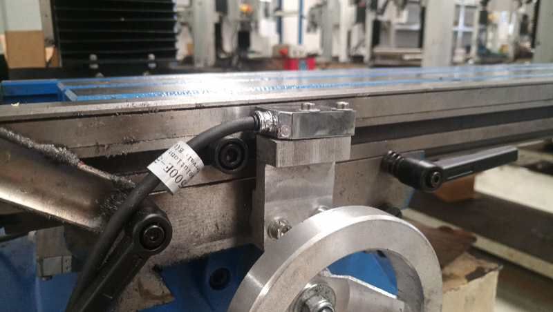

Looks like they put the X-axis one into the slot at the front of the table where the "tape measure" strip goes on the non DRO machines. Not sure if it is machined out to a different size at the factory.

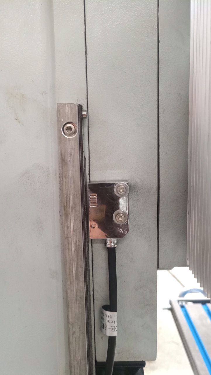

Y axis just stuck on the side

HI, Jason. That makes sense with the shape of one of the mounts. I will look into that. Can I ask you where you got the photos. I couldn't see them (or the VM32l) on either Amadeal or Weiss web site.

What is slight scary is that it looks like they've sawn the top of that sensor in order to fit it in!

It looks like the groove for the ruler is a good place to put the magnetic strip - short of actually trying it. Also, It seems I have two strips. A magnetic strip with a sticky back and a steel strip with a sticky back, so installing the strips looks fairly straightforward.
There is 1.8 metres of strip (each type!) which is plenty and more to cover the range.
Less pleasing is that it's still unclear how the mounts are meant to work. The one which most looks like an X mount simply won't fit.
I will try taking the ruler out and try fitting the strips, but I'm guessing I will have to make new mounts. Which is annoying.

Here are the instructions / photos provided by Weiss. First, I should say that I appreciate that someone took the time to take the pictures.
I'm not entirely sure I need to replicate all the swarf ridden bits of metal round it and I hope I can manage better alignment.
I have to say that I wouldn't call what I've received a kit. The brackets don't fit the sensors and the bar in the picture above is simply not there!
Having said that, I'm now fairly clear on what I need to do to put it all together, though I will need to make my own hardware I think...

There appears to be bits of old magnets used as temporary clamps holding the self adhesive(? ) strips in place, I also see the wonky looking sensor on the Y axis (has the casting a machined surface where the strip is located?). If the surface is not machined then there is a good case for fitting the strip in some extrusion. I think I would use some ali 'U' section (with the U upside down) so that the magnetic strip faces downward and the bulk of the sensor head is within the U, as in under an umbella.
Whilst the strip and sensors are probably coolant proof, oil and coolant could migrate its way into the adhesive allowing the strip to detach eventually.
