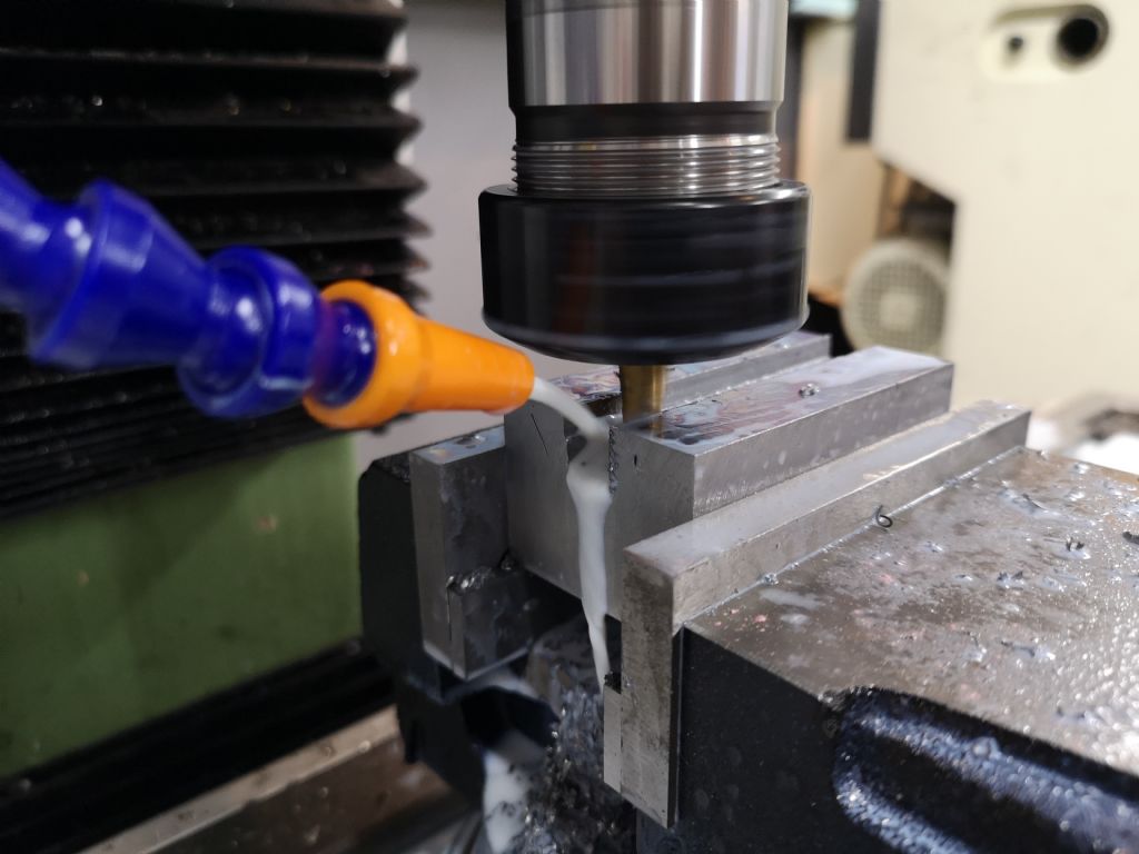

After taking the time to clean, square-up, mill to size and slot a part:
When it came to widening the slot (from 10mm to 22.8mm), the 10mm 4 flute milling cutter decided to dive into the work:
... and I have no idea why.
The part didn't move (it was still tight on it's parallels), so either the cutter was pulled from its holder or the quail was pulled down. However, although the quill was not locked (is this compulsory?) it was set to wheel (rather than big-pull-down-leaver-thing [scientific name]).
Any ideas?

Are you inserting the collet correctly into the nut before inserting tool and tightening it up? Are you doing it up tight enough?
Yes best to lock quill and head to column
How much did you move the cutter over per pass and what is the height of teh slot?
Edited By JasonB on 19/05/2020 13:52:04

Lock all unused axis when milling, also if you are climb milling put a bit of pressure on the axis used gib to save it grabbing.

Looking at the picture seems you were climb milling to increase the slot width.

I believe I'm inserting it correctly. The collet is gripping the plain shank and I did it up pretty tight.
1mm DOC. The cutter was touching, but not cutting the bottom of the slot at the time.

Bottom right to top left equals conventional milling.
Always lock the quill when it's not being used.
If the cutter span in the collet then it wasn't tight enough. But given it started cutting again I suspect it's a combination of a loose cutter and unlocked quill. Pretty tight is a bit vague, I'd suggest around 100Nm, ER collets need to be tightened rather more than you might think.

This is how to insert the collet
Was it a 10-9mm collet you used for the 10mm cutter

Much wisdom above, if you're using a cutter with a threaded shank e.g. for Clarkson collet, then turn down diameter of appropriate nut to fit down, inside collet. If screwed down tight to bottom of cutter & cutter is pulled down collet before tightening up, cutter won't run out of collet but as above, clamp each axis.

I venture almost everyone using ER collets for the first time falls into the trap of not inserting them properly into the chuck collar. The collet goes in at an angle and then clicks into position vertically. It's slightly awkward to do and unexpected. Done properly the base of the collet will be almost flush with the bottom of the chuck.
It's impossible to tighten the collet on a cutter sufficiently unless the collet has clicked in. Then the collet needs to be good and tight: ball-bearing collars are easier to tighten than the ordinary type.
Now I've sussed ER32, cutters only pull into the work when I forget to tighten them up.

Oh my goodness. Talk about a case of you don't know what you don't know!
  • A 10-11mm collet was used
  • The collet was not properly inserted/clicked properly into place (at least not intentionally!)
  • The collet needed de-burring
Right, what else do I need to know - tell me everything! smiley

ER collets were originally developed for tool holding. Tool shanks are normally hard. So when the collet is closed they do not 'give'. So if using a larger than needed collet the contact area becomes a line rather than a surface. Collet, and tool, runout and other parameters are only guaranteed if the collet is used at it's maximum value.

Either the quill was unlocked, or the collet was not tight enough, or a combination of the two.
If it is any consolation, I have had an End Mill pull itself into the work because the ER collet was not tight enough, when I took a heavy cut..
The helix on the flutes of the cutter will act like a screw thread and try to pull the cutter into the work.
(Which is one of the reasons for not using a Drill Chuck to drive an End Mill! )

Just looking at the first picture I would guess that the collet nut is not fully home on the body (at least, mine screws on significantly more than that) which suggests that the collet was not properly installed in the nut.

You will now also find it a lot easier to change collets as when snapped into the nut they are pulled out of the main body when the nut is undone, usually the nut loosens first then another turn or so and it will "pop" loose, This is when you need to be ready incase the tool drops particularly if you are using a cutter less than the max size of the collet.

For a 10mm cutter you should chose the 9-10 mm collet not the 10-11. Yes the 10-11 will tighten to 10mm but it takes a lot of effort. The only time I chose a collet that is larger than the size of the tool is when it is imperial.
