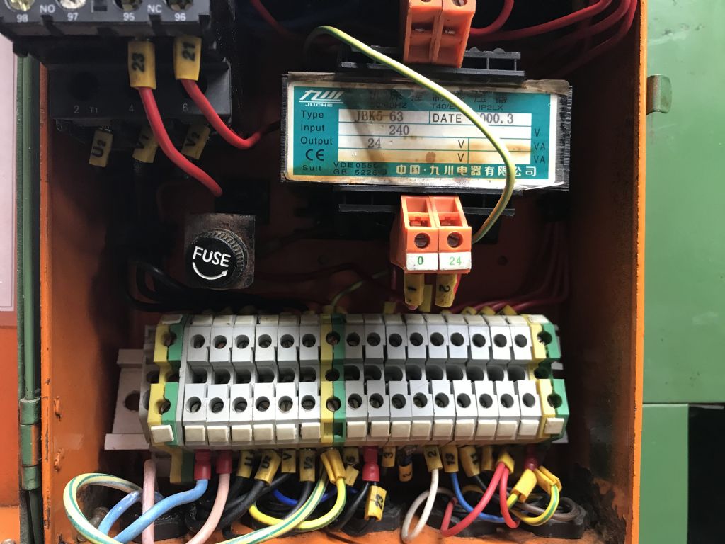

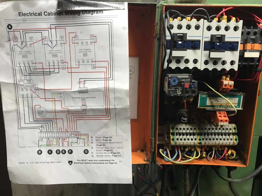

Hi all,
This is my first post as I have managed to find the answers I need to most things on the forum. However, I am now stuck!
I have inherited a Warco BH600 lathe which is in fairly good condition. Except for one thing. It will not start! The green light comes on but nothing else happens at all.
So far I have checked the following - plug fuse, machine fuse, chuck guard safety switch, change gear and top cover safety switch, start switch, emergency cut off switch, security of all connections, continuity of all wires, continuity and discontinuity of contactors, contactor coil resistance, transformer output (24v) and wiring diagram as per Grizzly 9249. The Warco wiring diagram is not to helpful.
I have now spent nearly 2 days trying to figure it out. The motor will run forwards or backwards depending which contactor I press. However, when I turn the machine on the contactors do not react and nothing happens when pressing the start button.
If anyone has any sensible suggestions as to what else to try they would be very welcome. I have looked at it so many times I think I have memorised the wiring diagram!

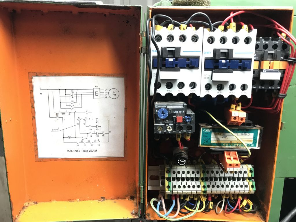

Not familiar with the lathe, but I'd start by checking the safety interlocks.
My WM280 has three; the NVR engaged, chuck guard must be closed and the panel covering the change gears must be correctly placed. After a while, my chuck-guard came loose on it's pivot and wasn't working the switch inside the headstcok properly: just needed tightening up.

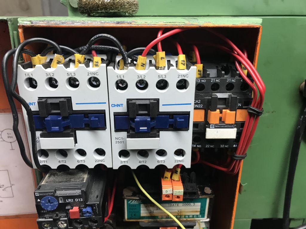

The circuit diagram in the door shows four switches in series at the bottom. K4 looks to be a thermal overload, if so probably on the motor. S5, S6 and S7 are likely to be the safety interlocks. The lathe won't run if any of the four are open. Check for operator error (left a door open...)! Otherwise look for a broken switch, loose connection, or need for mechanical adjustment. The Green Light means the transformer TC and fuse FU1 are OK, and 24V is available. That both contactors work manually suggests 24V isn't reaching them. Check for continuity and volts at each switch with a multimeter.

Sillyoldduffer - All safety switches are working correctly. Tested them open and closed. However, you mentioned the thermal overload. I checked that for 24v which it has on both connectors but .......... it is a normally closed circuit and there was no continuity between the two connectors. This may be the problem as it means there is a break in the circuit if there is no continuity between these two connectors at the normally closed connection.
I got a new thermal overload for £18 that is arriving tomorrow and will let you know the outcome.
Thanks again.

The control relay K1 which is the black telemecanique one needs to be energised before K2 or K3 will energise to start the motor. I would link out the safety contacts by putting a temporary link from 2 to 21, if the relay energises then you have an open circuit somewhere in the safety chain of contacts. There seems to be a question over the continuity of the contact on the overload so assuming it has been reset with the blue button then just put the temporary link across the contact and see if that energises K1. If the 2 to 21 link does not energise K1 then we need to look at devices 52 and 53, which from what Bazyle says is a switch operated from a saddle mounted lever, if we link 5 to 9 this should tell us if we have a problem with these switches being open. If these checks succeed in energising K1 will the lathe now start?

Solved !
It turned out to be a problem in the thermal overload switch where the normally closed circuit was not actually closed. Fitted a new one and now everything is running fine.
