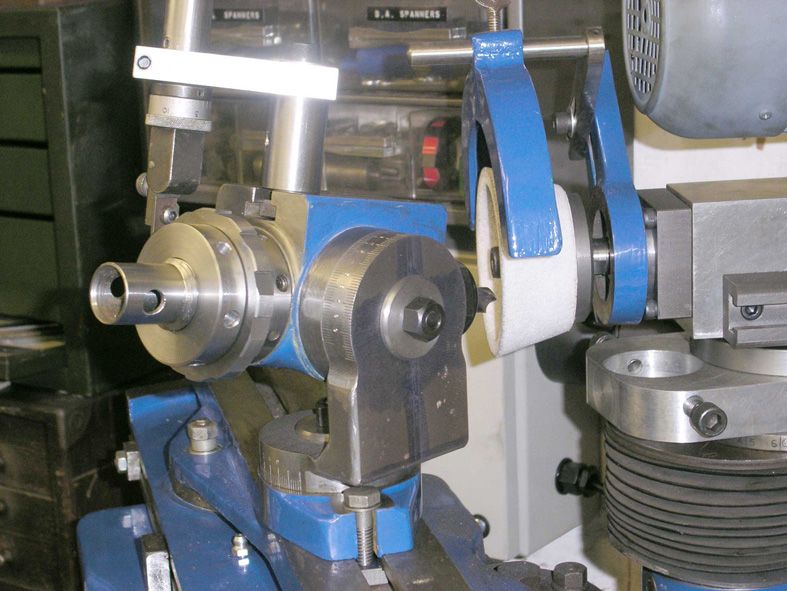

Clive
I already have a set up for doing Four Facet drills on my Union T&C grinder. I use DA collets on that rig up.
Phil
