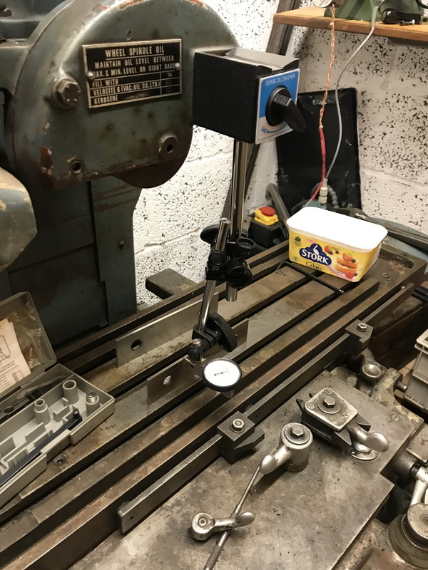

I’ve just got my J&S 540 full of oil and moving.
Its been run hard and put up wet in a previous life - it came from a mould makers IIRC.
I don’t have the spindle running yet, but though I might be able to take some indicative measurements to see if it’s worn out or likely to be ok.
I took the most parallel thing I have ( an import parallel from the mill) and stood it on a section of the table which is shiny and appears to be the original surface- it was I think under the mag chuck.
then I mounted my best indicator- mitutoyo tenths one that only comes out on special occasions - on the wheel guard with a mag stand.
Then I ran the table slowly under hydraulic feed to sweep the parallel.
Is this a valid method to get a measurement for wear on the ways?

Some, but a bit limited I would say.  You should try to get hold of a copy of Connelly's book "Machine Tool Reconditioning" for a thorough run through on measuring machine tool run out etc.
I'd question the use of a tenths dial indicator away out on the end of an extended adjustable mag base stand like that, with the flexible fine adjustment in the middle of one arm too. And then it's mounted on the flimsy wheel guard (by machine tool standards) which could introduce unwanted movement of a thou or three.
Mag base might be better mounted on the column with dial gauge as close to tthe base as possible to minimise springy overhang.
Parallel stood on edge unsecured like that could be likely to move enough to influence reading too.
Then there is the question of what you are measuring. The ways the table runs on could be well low at one end and that dial could still read zero as it passes by the gauge finger. It will measure if the surface of the table is not parallel to the sliding way surface on the bottom of the table at that particular point, maybe, if it is not riding on other points further along the ways.
The best way to really accurately measure way wear is to strip the machine and measure the ways with micrometers, dial gauges mounted on suitable "sleds" or sliding bases and/or maybe straight edges and feeler gauges.
Probably a more practical way would be to set the gib strips by feel. Set them so they are shake free in the middle of the table's run then see if they get tight when the table is slide by hand to one end or the other. Or go the other way and set gibs shake free at one end and then see if there is slack in the more worn middle section.
Then you are probably better off to set a job up in the machine and take some trial cuts and measure the resulting thicknesses. A couple of test strips about the size of those parallels you have laid down flat would probably suffice.

The short answer is that it isn't going to tell you anything particularly useful. At best It might give an indication of the quality of the parallel, although given the narrowness of the parallel and overhang of the indicator I doubt even that. I'd agree that the condition of the ways is likely to be the least of your problems. The ways don't wear like those on a lathe for instance for several reasons:
The cutting forces are very low - on both my surface and cylindrical grinders the tables just rest on the ways, there's nothing holding them down
The ways have a large bearing area compared to the forces
They should be continuously lubricated
The ways are well protected from grinding dust
The ways are in contact over the full area most of the time, unlike the saddle on a lathe bed

I didn't think it was a very good way to measure, hence asking. My thinking was that rather than cutting the block to size as it passed the 'wheel' if there was a gross deviation then the indicator would show it - something like 'banana' ways for instance.
As it happens the indicator shows well under a tenth deviation. I took a video, but not sure how I could post it?
The smooth movement of the hydraulics means the thin parallel stayed stood up and didn't move at all over multiple passes.

It's very possible to have the machine so worn that it produces 'bent' parts and grinding the chuck will not fix that nor will the popular test of putting blocks on the corners of the chuck and grinding them to compare the thicknesses.
I had one of these and the cross axis ways were so worn that anything I ground was convex in the short axis. i did set about re-scraping it but after a lot of work lost heart and got rid of it, mostly because I didn't have a straight edge to fit the cross table ways (you can't fit a regular straight edge in there) and because the wear so so bad that the cross slide screw and nut were trying to carry the weight of the cross slide and table.
You can use your test to check for 'banana ways' but orientate the straight edge across the chuck and check that axis. If the ways are straight it will either indicated evenly along the length or have a gradual rise or fall on the dial. If they are as badly worn as mine the indicator will fall then rise showing a low reading in the middle.

If the cross table ways are worn and you grind the chuck you'll be grinding the chuck convex. If someone hasn't already done it.
Dave S25/04/2020 12:54:08
433 forum posts
95 photos
Crosswise on the 6” parallel is less clear.
Might be a ramp of about 6-8 tenths, but sometimes it appears to be a dip of 3-4 tenths, but not consistently and not at the same point in the travel.

It's a sign of wear in the slide. I'll try to do a sketch to explain it.
EDIT: I don't have to - I found an old pic of the wear on mine.
As you can see the ways wear low at both ends and this causes the cross table to travel in an arc instead of a straight line. When you put the parallel on the chuck it IS straight, so making it travel in an arc with the table will give a high reading at both ends. The reason you're getting different reading in both directions is probably because the table is rocking ever so slightly away from the direction of travel.
As you can see - mine was badly worn, much more than your indicated figures.

Since you are measuring with a tenths of a thou indicator, you are looking to be able to detect, accurately, differences of less mthan a tenth.
You cannot afford to have flexibility of anything near a tenth, so the DTI mounting must be as rigid as possible.
If there is any detectable flexibility, it will be difficult to tell if the deflection is ,wear (that you want to measure ) or flexibility which you can't; and don't want!
You can't measure accurately with a graduated bungee cord!
