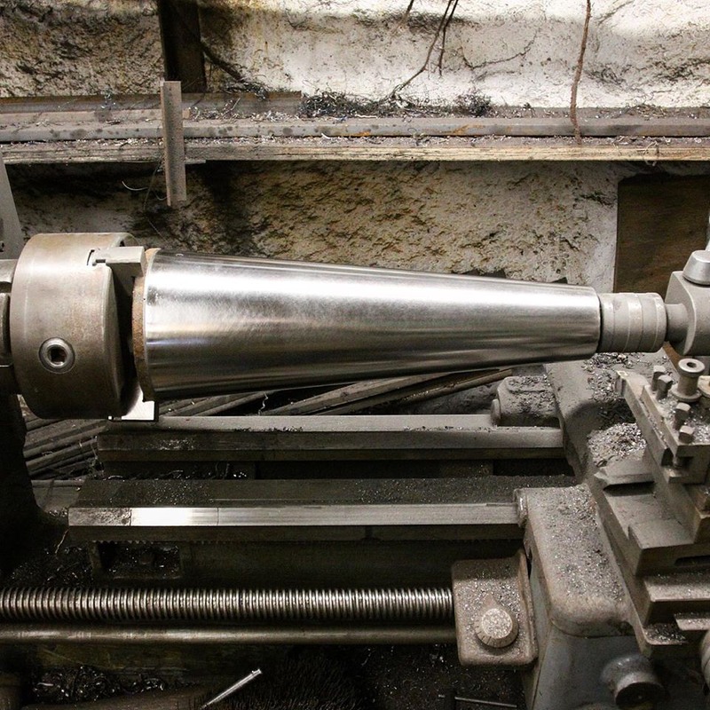

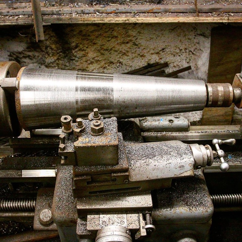

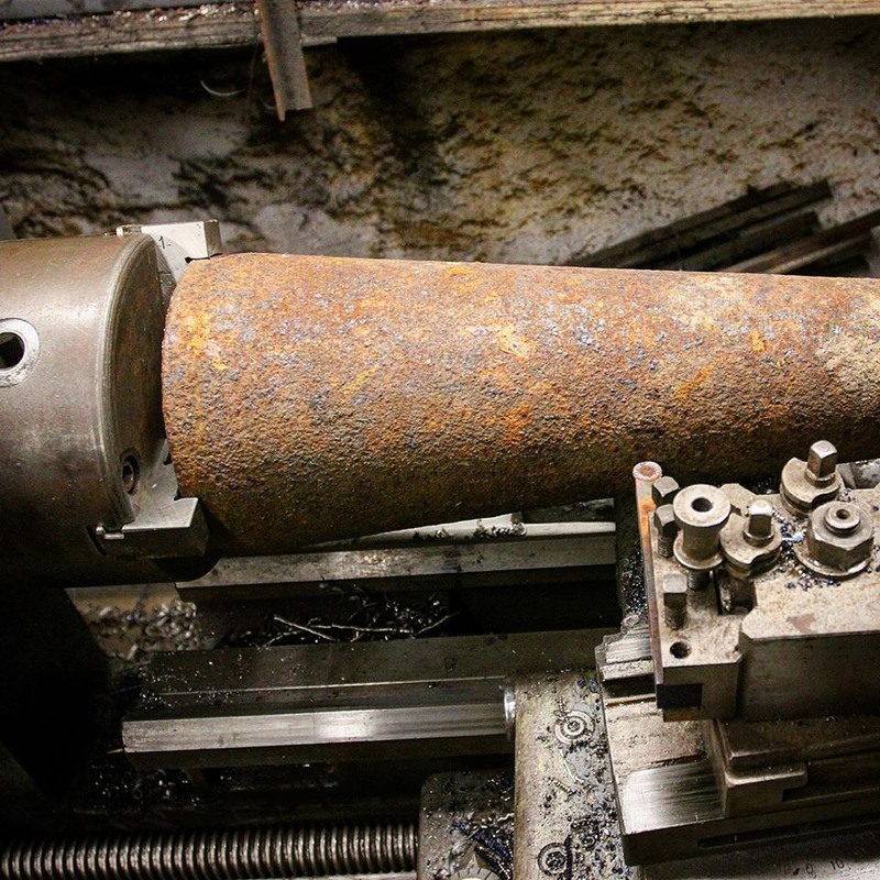

I often need to clean up tapered tools for jewelers and silversmiths and am limited by the 3" of travel on my topslide. I was wondering if making a longer top slide was a viable solution. I was thinking of powering the slide by using a small 3-phase motor and VFD. It seems simple enough but was wondering why nobody seems to use that method.

From your last pic, you seem to me to be doing nicely wiv wotcha got.
I'm guessing that the drawback to an extra long topslide is the potential mutual obstruction between topslide handwheel at full retraction and tailstock, unless you have a chatter-prone tool projection at the toolpost, or some special toolholding arrangment to counter that.

OK, but the OP's illustrated piece would need a pretty big offset and also present what look like serious issues gripping the headstock end on the slant.
