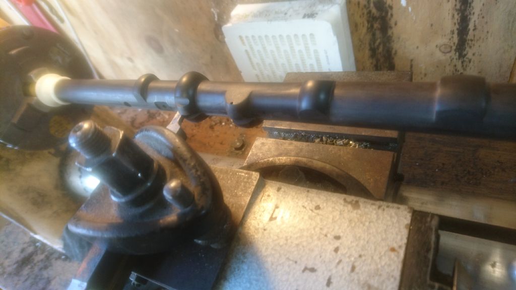

Hi. I make wooden things for a living, and do a lot of work with non-ferrous. I'm finally going to get myself a "proper" lathe, I'm thinking ML7 size. I need a distance between centres of at least 19".
I have a question - is it possible to have the headstock stationary, and use the lathe motor to move the carriage from side to side to cut keyways in hardwood? My hands get v tired moving the compound slide around on the ML8. If it is possible, is it possible on a ML7?
The ML8 is cutting the slots slightly uphill, which is no good.
The other thing I need an engineering lathe for is making tapered (mainly) reamers. I'd also stop turning my brass on the ML8, although it does work surprisingly well for this with the compound slide, and I have made accurate conical reamers from mild steel too.

Powered feed on a lathe is normally driven by the rotation of the spindle and therefore a chuck fitted to the spindle will rotate as well. There are a few ways to overcome this for your needs, mount the workpiece between centres and use a clamp to stop it from moving (omit the lathe dog that would usually be used to turn the workpiece) is the simplest. Alternatives are to adapt the lathe with something like the electronic leadscrew (ELS) or to go full CNC. I think the second two are probably something you don't want to do.

One way I might do as you are asking is to power the leadscrew alone, probably better done with a second drive and leave the headstock un-powered. It isn't difficult to isolate the gearing up to the headstock, just take one of the linking gears out when you run things that way.
The new drive could also be readily arranged so that you still retain the option of using the lathe as the makers intended.

As regards the slot cutting (and I know what the job is btw) you will not need a power feed, racking the carriage to and fro with the carriage handwheel will suffice. For shorter slots (up to perhaps 2" long) you may well be able to rig a lever across the face of the handwheel which will make things very comfortable. I can't remember where, but there is at least one video on Youtube showing this operation.

Rob - I am currently racking the compound slide to and fro, and there's a lot of resistance. I have a 3mm cutter that I have backed off all round so it doesn't bind - it produces an excellent result without any of the worry I'd have from using a powered cutter. Thanks for the book recommendation, I'll read. I have used metal lathes a bit but certainly am short of knowledge.

Instead of racking the carriage back and forth you can convert the top slide into a slot cutter pretty easily. All it takes is remove the top slide feed screw and set up a long handled lever that pivots on a tower sticking up from the rear T slot in the cross slide and is attached with a link to the moveable top slide by bolting to the toolpost. Much easier than racking the carriage. You could even conceivably motorize the top slide with a stepper motor or motor and crank etc.
Or for wood, get a cheap router motor with integral collets and fit a cutter and mount it on the toolpost and use it to rout/mill the slot instead.

This is what I'm actually doing, there can be up to 8 key slots on a chanter. I really don't like the idea of having to do this on a mill - I do possess the ability to mill and do cut slots in drone reed bodies using a cross slide on the substantial pillar drill. I know a milling machine is more accurate than this, but the clamping problem remains the same.
A milling machine would be useful for removing the stock on the D reamers, but not essential.
I can't see how I'd fix even a laminate cutter here and have the bit at centre height. Other makers I think use a dremel, or the remote flexy thing and mount that.

When my hands are sore, I start the slot, then saw slightly inwards on both sides and knock that bit out - this leaves the tool v little work to do and I could maybe then remove the feed screw if I always did that.
