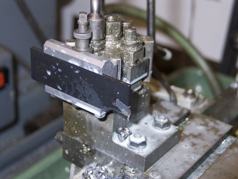

old mart01/02/2020 21:03:45
4655 forum posts
304 photos
I made a rear parting toolpost for the Smart & Brown model A which takes industrial 26 and 32mm blades. The top half can be turned around and it is positioned right on the edge of the cross slide. No adjustment is required, as the carbide inserts are not ever sharpened. Because the forces are upwards, I also added a rear saddle lock, which was easy as the rear screw hole for the travelling steady was in exactly the right position, and the locking screw passes through the existing tapping in the saddle. The locking clamp is easy to remove if the travelling steady is used. It is visible in the picture.

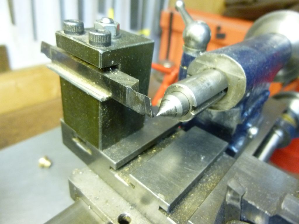

I made a "Norman patent" rear parting tool post and holder for my S7LB.

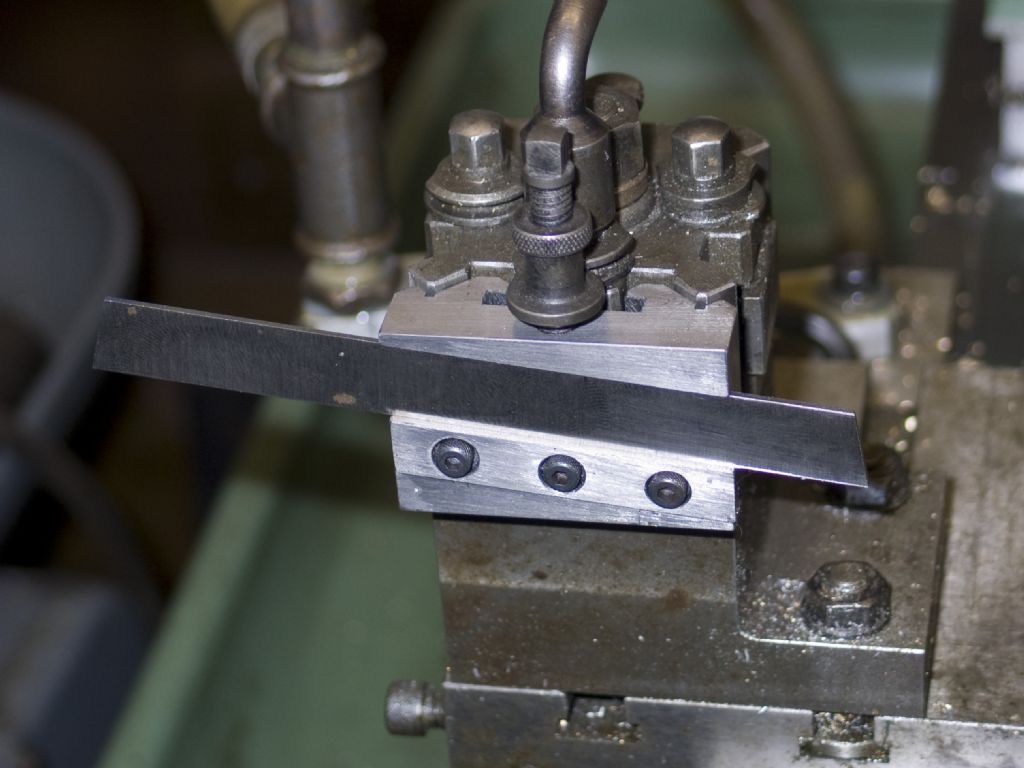

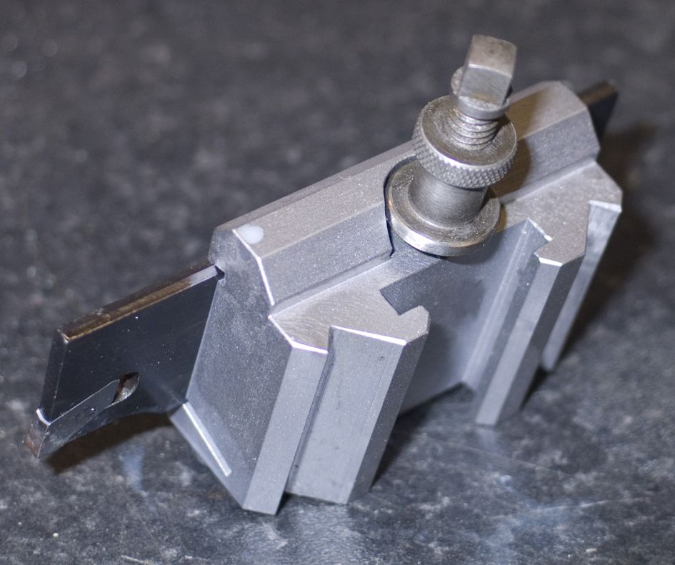

Phil P01/02/2020 22:22:41
851 forum posts
206 photos
This is my solution.
Parting Tool Holder 2
Parting Tool Holder 1

Beware of putting severe tension loads on T-slots. John Baron's toolpost obviously hasn't caused the T-slot to break (yet...), and he has fitted a reasonably long nut. I think I'd use the longest nut I could fit and would ideally spread the load by fixing the post to the nut in more than one location. The Myford/Thomas style above takes the T-slot protection further by spreading the load between two slots. The quick-change holder then adds flexibility and moves the forces outside the footprint of the post. Nothing is ideal, is it?

My rear toolpost is similar to John Baron's, except mine is clamped to the cross slide using two nuts per T-slot.

There looks to be a lot of overhang on that setup, just be aware that the tool and its holder will flex when taking a cut.
