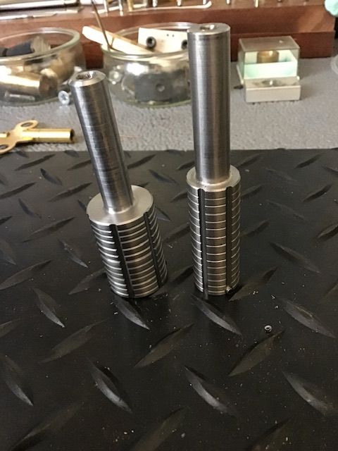

05/10/2023 07:56:24
Okay now the next problem my controller will only accept 12.4 or 12.5 not enough digits to put in 12.452 but there is another setting for cone ratio that overrides other settings but I don’t have the first idea how to get the cone ratio, a google search didn’t help anyway not sure it would help without trying anyone know how to work out the cone ratio ?
Dell
03/10/2023 19:31:50
Thanks for replies the 1.725 was a typing error I don’t know how the 2 got in there, will blame it on my age anyway I have just found a calculator online and the taper length should be as Mike said 12.4mm giving a taper degree of 8.033 so that’s where I was going wrong , it just goes to show that it’s worth doing something that we have never done before using a bit of scrap, anyway I will cut another bit of scrap aluminium again tomorrow just to be sure.
Many thanks Dell
03/10/2023 18:33:15
I am hoping someone on here can help me , I have the soft blank to make an ER11 collet chuck for my Pultra and I am unsure about the internal taper, according to google search the included angle should be 16deg but when I cut the taper in a bit of aluminium using Rocketronics, large end 11mm and 7.5mm small end overall length of 17mm so putting -Z17 and -X1.725 being half the difference between 11 and 7.5 I get 5deg ( so 10deg included) and not 8deg ( 16deg included) what am I doing wrong ?
I want to get this sorted out before I do it on the proper arbor.img_1953.jpeg

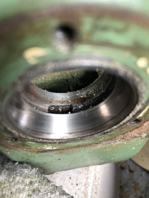

02/09/2023 17:12:50
Just purchased a Pultra 17/70 with leaver tailstock and 160 collets yes 160 it had been used from new just to make fishing floats so you can imagine how much wood dust there was, I have stripped it to give it a good clean and revamp and to my surprise it has roller bearings, I didn’t think they made them like that , I know when Smart & Brown took over they made them with roller bearings but they didn’t have oil sight glasses and this one has oil sight glasses, oil cups and grease nipples so the only thing I can think is it was made during the change over period from Pultra to S&B, I am going to order some new Timkin bearings because the old ones are very dry so may be worn.
I have all the conflex collets soaking in Evaporust and will do the others later they are not conflex but they are a good fit and correct thread so will have to look in book to see if I can find maker.

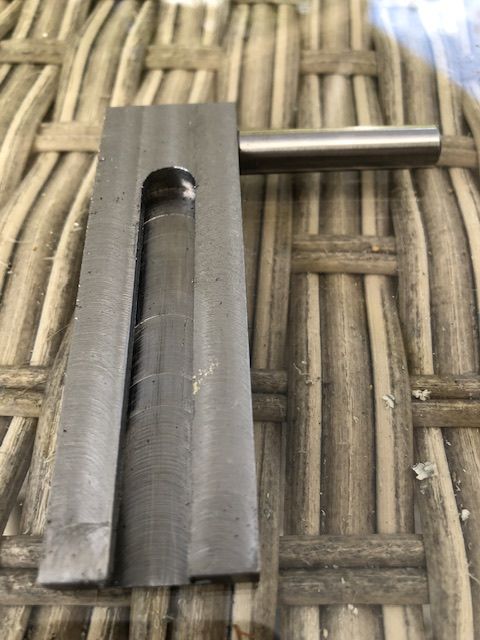

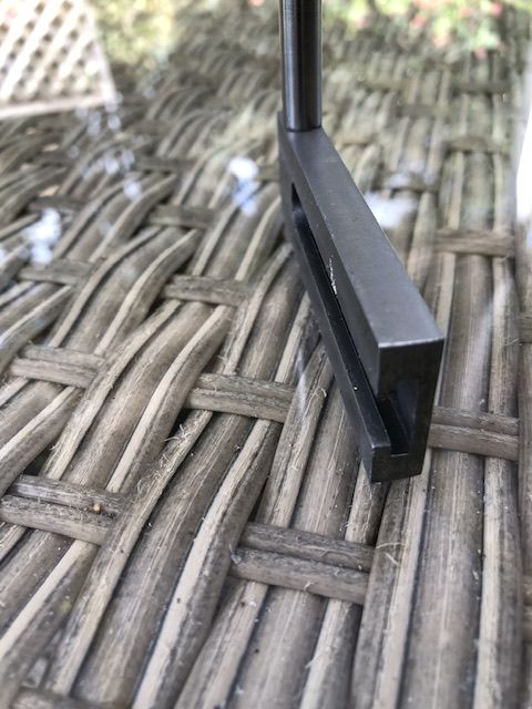

04/08/2023 11:02:09
It wasn’t along its length it was is the side to side that dished ,as I say it’s not a problem with this part , I was just wondering for future reference when something more critical in size is needed, I have since measured and the slot I cut in first 8.6mm wide now measured 8.67, although it is less the further in towards the closed end but that would make sense as more material there. so not a great amount but if it was some critical part 0.07mm could make a difference between fit and not .
Dell
04/08/2023 08:10:48
As I said in the original post , I squared it off meaning I milled all four sides and both ends but it looks as though I didn’t milk enough off both sides to release the stresses.
Dell
03/08/2023 19:29:54
Thanks for all the replies, so next time ( if there is a next time ) I will coat in borax and heat to red then let cool.

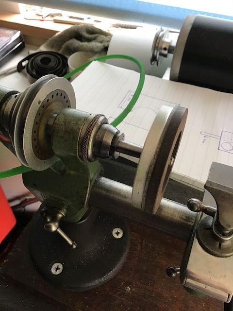

03/08/2023 17:13:43
I am in the process of making a copy of Levin’s diamond watchmaker graver sharpener ( see first picture), I started by making the arbor to mount the diamond wheel to my Pultra then moved onto the base that fits onto the mounting point where the tool rest goes.
I started by milling the steel square ( or should that be oblong ), then cut a slot 4.8mm deep X 8.6mm wide then to cut the T slot I had to use a woodruff cutter because I couldn’t get a T slot cutter small enough, very slow going on my very small Warco WM12 , as I am going to nickel plate to guard against rust I needed to sand to remove tool marks but when I offered it up to the sander it only sanded the edges not the centre it’s not a problem with this part because it’s only the base but for future reference it would be nice to know if cutting the T slot was the cause.
I haven’t been able to find anyone with the tool to be able to get measurements so I am having to do it best I can.
