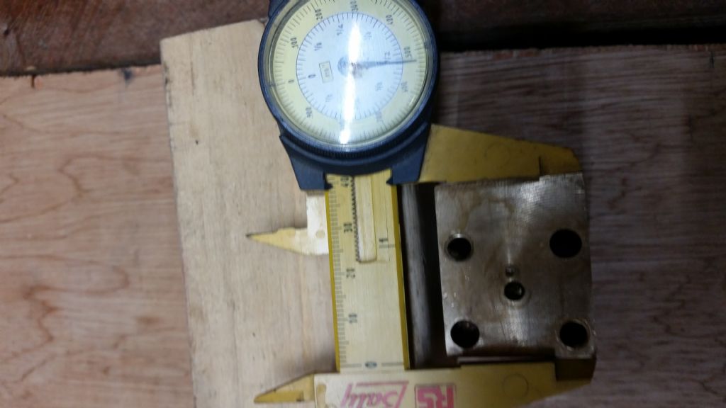

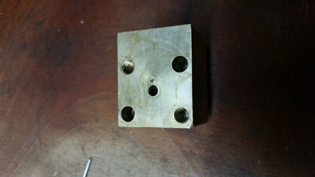

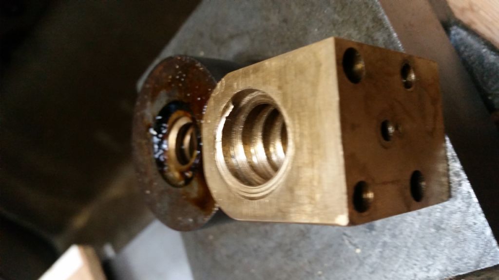

Frank lyszkiewicz28/01/2020 18:06:15
10 forum posts
4 photos
Frank lyszkiewicz28/01/2020 18:09:26
10 forum posts
4 photos
Hi all these are some pic of the screw and the acme nut as you can see in the second pic it is badly warn

Have never tried this, but since this is a one off.
Turn a male thread, 7/8 x 4 tpi,, in hardenable steel, such as Silver Steel
Gash it longitudinally, so that becomes a Tap.
Harden and temper.
Select the raw material for the new nut, and at the appropriate time in the sequence of machining it, (so that it can be held ) drill core diameter, or a couple of thou oversize, and Tap your Left Hand nut..
As long as the Leadscrew is unworn, your lathe should be able to do the machining.
Howard
Pete Rimmer28/01/2020 18:35:16
1486 forum posts
105 photos
7/8" 4TPI is eminently do-able. Last week I turned a 3/4" 5TPI last week that I was a little worried about because of the 1.8" depth but in the end it was straightforward.
Frank if you send me your leadscrew and nut I'll have a crack at it.
Pete.
old mart28/01/2020 19:02:24
4655 forum posts
304 photos
From the ACME thread calculator that I use, the core will be at least 5/8", or a bit more, certainly achievable. **LINK**
