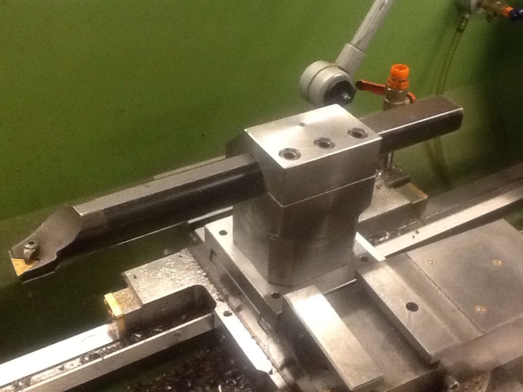

For quite some time I have been meaning to make a toolpost to take a large boring bar, to be used in place of the topslide and its toolpost for a far more ridgid setup.
I finally completed one during the past couple of weeks, starting with a block of 80mm square black bar for the body, and some 15mm thick steel plate for the base. The body and the base were both machined on all faces then dowelled and bolted together. The hefty lump was then bolted to the lathes tee slotted crosslide and the bore for the boring bar was first drilled and then finished with a between centres boring bar gripped in the lathe chuck.
...............The base is secured to the body with five high tensile M8 cap screws, plus two dowels. A key is also fitted to locate in the tee slotted crosslide. The lathe is a Warco 1330 but the topslide is a Myford 280 item that I modified to fit several years ago.
image.jpg...............The completed toolpost after slitting one side and fitting three pinch bolts to clamp the boring bar. I was originally going to use a slitting saw in the mill but in the end I used my 7x12 bandsaw. The boring bar will be used to bore the cylinder on my BSA B50.image.jpg..........image.jpgimage.jpg

Were you aware that the recommended diameter to length ratio of a steel boring bar is 4:1, solid carbide is 6:1, the most expensive bars can go to 10:1, and they cost somewhere in four figures. That cylinder really needs a 3" diameter bar, and a much bigger lathe.

Well there lies a possible snag, I had it in my head that the ratio was 5:1 so this boring bar would be right on that limit.
I had been looking for a bar of 40-50mm diameter, but all the used ones I have looked at so far have been worn away in the area below the cutting tip.
While the bigger the better for this job is true, it doesn't require going as far as a 3" bar. The 1330 lathe is heavily built and more than up to the job of holding and machining the light alloy cylinders bore out by 0.5mm, once I have made a suitable holding fixture.

I've bored several motorcycle cylinders from about 50mm to 90mm diameter using a 25 mm boring bar. By the looks of it the same bar as the OP is going to use (25mm diameter), vibration isn't a problem even though the bar is hanging out of the tool post rather more than might be ideal. Slow speed, 300ish rpm and a brisk feed works for me. I leave a 0.002" for honing.
Boring the cylinder on the original cylinder centre line isn't that important, a few thou out is not going to matter. What is important is that the bore is exactly perpendicular to the cylinders mounting face. If at all possible I always take a light cut across the mounting face at the same time as boring the cylinder.

I can't think of a single time I have ever used a boring bar that large in diameter in relation to its length. Not once. A half inch diameter boring bar will cheerfully bore a hole four inches deep if used carefully. Not under high-speed mass production conditions perhaps, but ok on one-off jobs.

Assuming the rigidity and resistance to chatter is dependent on stiffness of the tool (a cylindrical beam).
After some digging, it seems deflection is proportional to the cube of length over the fourth power of diameter.
In practice I've never had problems with a 3/8" bar extended by well over 1 1/2" taking decent cuts on steel.
A 1" bar will be 50 times as stiff as a 3/8" bar of the same length (fourth power of the difference in diameter), and so can be 3.70 (cube root of 50) as long to be similarly stiff.
3.70 x 1.5 = 5.55"
The 1" boring bar should be fine, and you can always halve the depth of cut to halve the load.
<edit> I think we are all familiar from practice, if not calculation, that stiffness of a bar decreases rapidly with length, and many of us know the cube root relation (e.g. a 1" long bar is eight times stiffer than a 2" one). We also have an intuitive understanding that stiffness also increases with diameter, but is suspect that most of us are less aware it is a fourth power relationship (e.g. 2" diameter bar 16 times as stiff as a 1" diameter bar). I'd come across this before but it had fallen off then end of my memory until I looked it up. It's hard to find a simple answer on line as most websites use the "area moment of inertia" in the calculation so it applies to any shape. For a circle, this is proportional to radius to the power of four. (Yes I looked all this up)

This may be a wildly foolish idea, but if there is any uncertainty over deflection, could you put gussets under and behind the bar?
How much is there between the outer face of the bar and the point of the tip? You could shrink or loctite on a sleeve that increases its effective diameter. Even an eccentrically-bored one so that the under and back get more meat than the front.

No it's not a foolish idea. Here are two examples of an old 25mm boring bar that has been lengthened and reinforced by a length of thick flat bar at the back, and it cuts cleanly without the slightest chatter.The bores being machined on these full size Traction engine parts are deeper and larger in diameter than my BSA cylinders. I won't be doing this to my nice 32mm boring bar, but I have already started to make a sleave to stiffen it up when extended to 5x its diameter.image.jpgimage.jpg
