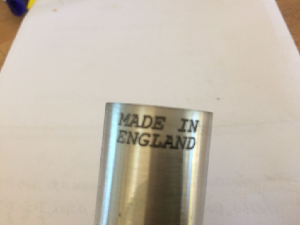

Would anyone know of an engraver or engraving service with reasonable costs. I want to have the top slide index drum engraved similar to the cross slide one pictured below. We had a local engraver with very good pricing but he is retired and the other local engravers prices are scary.

Can you do the division lines yourself with a simple pointed tool either on the lathe or mill ? This would reduce the cost. Some engravers up here in the Midlands but getting fewer as the industry declines. Diegrave in Walsall come to mind as one still going
geoff adams09/09/2019 08:43:07
214 forum posts
207 photos
Hi Ron i did this on my cnc mill 4th axis if you can give me the dia to be engraved and dims of the lettering and graduations i will have a go at engraving it

Chris, it did cross my mind as to whether I could do it myself, I have a decent rotary table and you can get small engraving bits. I probably dont have the speed on the mill for such a small bit but it may be ok as the lines are very shallow. I will give it some thought.

if you wanted a simple project Harold Halls design provides for accurately lengthed graduations. Just 'scratching' with a suitable tool bit makes neat engravings for dials, you don't necessarily require high spindle speeds...

Done with a lathe tool on its side, indexing using a change gear at the back of the spindle. Numbers stamped with ordinary punches using a guide held in the toolpost.

Lots of ways of doing the lines. I did mine wth a sinple indexing tool I made up using the mill circle function and quill to score the lines. The problem i had was the diameter of the knob was small enough that punched numbers were weak at their sides. The only solution i see to that would be repeat indexing a small proportion each side of the line and re-striking the punch? Perhaps it'd be possible in some applications to etch a brass strip for insertion or mark/punch a thin steel strip??

With a mill and rotary table, that sort of engraving can be done. We did two, one with 118 divisions and numbers every ten, and another with 125 divisions and also numbers every ten. They are fitted to the lathe cross slide and the tailstock. A jig was required to hold the punches for the numbers. We took the easy option and made them out of aluminium.
If I remember, I will take pictures of the engraver. It is a simple push type using the quill, I tried rotary tips with unusable results.

The inserts have VCGT 1604 printed on the box, but I think the tip rads are much smaller. You would have to use a magnifying glass to see that there is a rad, and not a sharp point. If using a rotary table to do the engraving, it would be important to get the work running with absolute minimum radial runout. I had to lock the mill spindle from rotation, as the slightest movement would ruin the spacing. I couldn't do anything about the backlash between the quill splines and the pulley which was locked, but luck was on my side that day. For the 118 graduations, the RT had to be set to degrees and minutes. Keeping concentration while cutting the three lengths of line was too much for me and there are a couple of mistakes on each scale.

Aluminium is much easier to work with than steel, including the straight knurling on the lathe cross slide wheel. As for the jig, it only does one size and to avoid the variations in depth of the punch marks, it is preferable to do all the stamping exactly on the centre line. This would need some marks on the jig to space the numbers each side of the engraved lines equally. Doing test stamp placings on a flat piece of metal and measuring the pitch of the most visually pleasing pairs would be the best method. Two marks for double numbers, and three different marks for single and triple numbers. The stamping on the cross slide wheel was done using the jig, and the tailstock was freehand, and it shows.
As in the video, there are long curled burrs left as the tip cuts, I found that brushing them with a brass wire brush gets rid of them quite well (real brass, not brass plated steel). The aluminium needs to be a hard alloy, not soft pure stuff.
