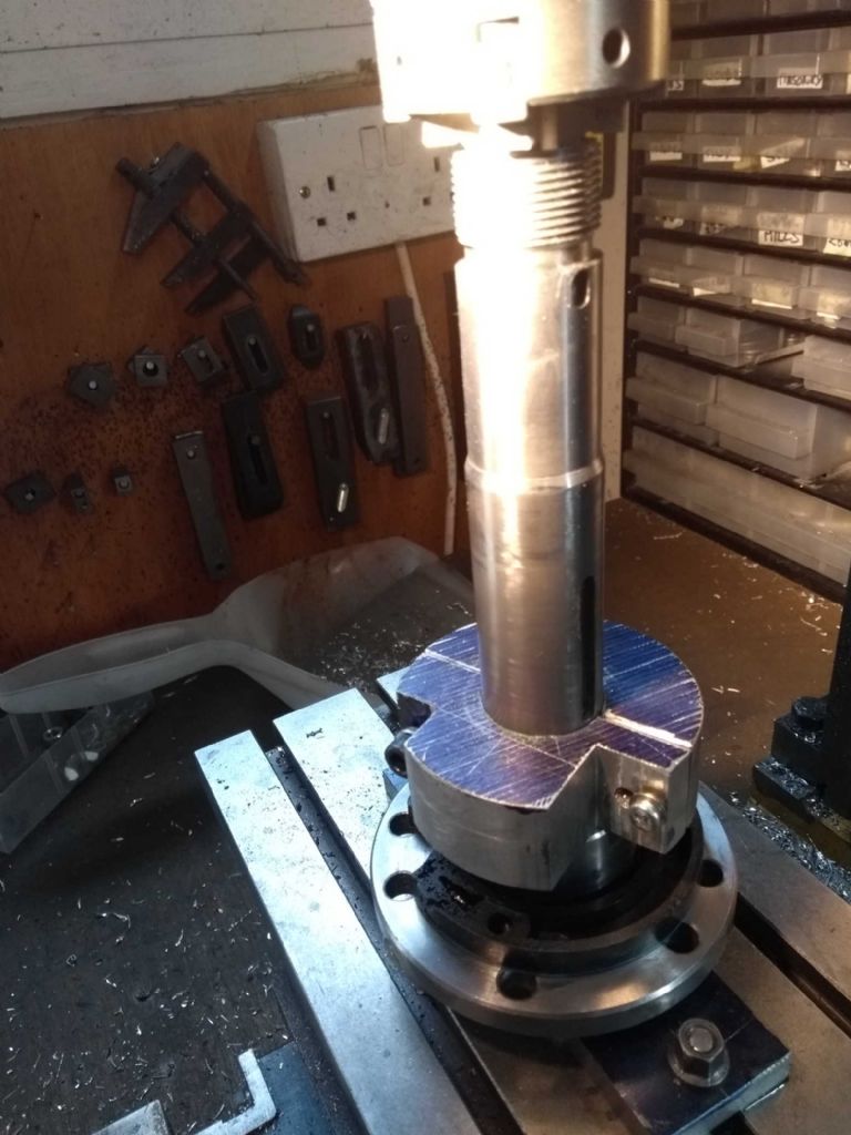

I'm thinking I might try and make a spindle polisher with my micro mill.
I have a 4 jaw non-independant chuck on an MT2 spindle which will hold the back end of the spindle and I'm thinking of making a very short centre to slot into the other end of the spindle. That will engage in a centre drilled hole in a shallow bar on the mill bed.
I have the old spindle and with a bit of luck it might just fit.
he idea was to turn a spindle on the end of a short piece of bar which would exactly fit in the spindle, together with a threaded hole. Turn it round, put the spigot in the spindle, tighten in place with the bar and turn a center on it. The idea is to have no more than a bout 10mm from the spindle face to the point of the centre.
My first attempt at this has not been too grand. I cut a spigot in a piece of 50mm bar which very nicely fitted in the end of the old spindle. The new spindle unfortunately has a narrower aperture, so back on with the chuck and cut. Unfortunately too much, so the damned thing rattles and is easily offset with an over firm cut. So I think I will have to start again and be a bit more patient with the cutting and chuck swapping. Needless to say if I if I take the piece out of the chuck, the chuck off and replace the chuck and piece, the chance of it being centred is slim. I will consider my 4 jaw for this, though I can see a certain amount of frustration ahead of me.
In the meantime, it's time for a cuppa and some dinner. Not sure if I'll get back to it this afternoon - we're off out for tea a bit later - and there's only so far my patience will stretch in a given day!.
Iain

Rightio.
The plan was to remove the spindle from the lathe and mount it in the mill with the unholy collection of components shown below.
Underneath the bit at the front with the cone is a spigot which fits nicely into the spindle throat. The top end of the spindle gets gripped by the 4 jaw in the mill spindle. the bottom end slots into the coney thing and the cone sits in a centre drilled hole in the marked up plate which is bolted to the mill. Once I drill the centre it's going to be difficult to do anything else with the mill until the work is finished so that's the last thing to do. As the spindle rotates some (probably) 1000 grit will take a little bit of the surface enabling a better fit.
So, next was to strip down the lathe and press the spindle out. The stripping down went fine.

OH - if anyone can provide more detail guidance about how to do this polishing and fitting, I'd appreciate it. I guess it's just a strip of wet and dry and keep trying the bearing. but I'm not sure what a slide fit consists of - and if I should lubricate to get it on.
Iain

When you have pressed the remains of the bearing inner off the shaft, you may find that the burnishing of the shaft has made the rear bearing to be an easier fit when it is replaced. When fitting the new bearings, there must be a way of applying pressure to both inner and outer races simultaneously to avoid damaging them.

I'm waiting to be shot-down for this; but let me tell you how I did a very similar 'fitting' job
[ it's the quality of the grinding that's the problem ]
When the bearing was eventually removed from the spindle, there were several quite clear longitudinal scuff marks on the spindle [not scratches as such]: It was evident that the spindle was not exactly round, but slightly lobate.
I sat quietly in the sunshine with a fairly worn fine-grade Diamond hone [*], and gently removed a little more from those scuffed high-spots ... then tried the bearing for fit ... and repeated this cycle until it felt right.
All this was done by hand, with the spindle resting on my knees.
The correct fit is usually that the bearing can [just] be slid by hand onto the spindle. [no white-knuckle stuff please]
Those with all the right tools, in tip-top condition, would do it differently ... but it was a satisfying way to spend a sunny afternoon.

You could make a split lap to polish the shaft. The lap needs to be made of something softish, brass or aluminium for instance, bored to an easy fit on the shaft, and then split with a saw cut and drilled and tapped for a screw that can be used to close it up slightly. Then you can lap the spindle, using a bit of fine valve grinding paste. You can work the lap by hand since the lathe will be out of action. This is quite a slow way of removing material so gives quite good control. The spindle wants a good clean afterwards of course.

It occurred to me in the early hours of the morning, that the front bearing doesn't really need to slide as long as the back bearing slides freely.
If the inner shell is jammed a little bit before the end of the shaft, then it is still firmly in place. It's the back bearking that certainly needs to slide to pull both bearings together.
Is this right/ If so I need only concentrate on the back part of the shaft.
Also, I don't think it's possible to support both inner and outer shells for all the operations. I think the order of operation is probably to press home the bearings in the headstock and then press the shaft through with the rear bearing fully supported. That leaves the inner shell of the front bearing pressed on the shaft.
Of course if the shaft is a slide fit then this puts less stress on the bearing.

Hi, All.
Some time has been spent working on the spindle. John - I took your advice about a split lap.
I had a handy piece of 1 inch wide 3 inch aluminium bar which I cut some shoulders on, drilled, and bored out.
With this being the 'finished' product
The offset shoulders is not some clever attempt to apply differential pressure, but as a result of my 6mm tap breaking off in the left had hole. This was most annoying, partularly as it was my favourite spiral tap. Finished the other hole off with my traditional set and hten drilled and tapped to 4 mm on the left having reduced the shoulder as you can see.
Although the original advice was for valve grinding paste, I actually don't have any of that, but I do have a set of diamond grinding paste. I started off with what I think is 5micron (green) and after 10 or 15 mins I didn't see much change I upped to 10 micron (gray). I'm testing this by attempting to press the bearing home with my fingers after wiping the paste away.
As I was getting bored turning the lap by hand, I finished of my polishing machine.
Which seems to work rather well. Thankfully, there's enough throat to be able to take the spindle off without moving the lower plate so it stays nice centred.
I would like to ask if 10 micron grit is about right - and how long I should expect this to take. The last thing I want to do is to take to much off!
The other thing which I found was that the bore in the split lap was not round. it's a thou ish different across different axes. When you're boring on my little mill there is a good deal of vibration and I think that the head is more rigid in one direction than the other hence less movement and more cut.
I don't think this invalidates the lap, mind you, just something to think on in future.
Iain
old mart08/09/2019 18:58:33
4655 forum posts
304 photos
Don't go overboard with relieving the fit of the bearings, they weren't designed to be sliding fits. You could easily end up with a scrap spindle.
