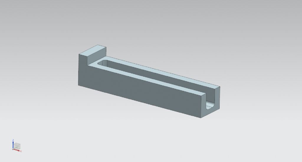

Hi I have brought a new warco WM18 mill but i'm having a few teething problems (partly because of best changlish and partly re-learning possibly lacking a bit of bravery to!).
firstly when i'm trying to take a cut in the z axis i can only take out about .5mm not too much of a problem but its just lots of little cuts.
if i dare to attempt to take more out it feels/sounds like the machine is going pull its self out the ground!
the other issue im having is when taking a cut some times it would appear that the z axis is dropping half way through a cut but I think this a temperature issue i only say this as after it has happened the tool is too hot to touch. short of water cooling (funds wont allow just yet) is there anything else i can try?
im using a 4 flute 16mm HSS cutter running at 1500RPM (spindel speed). iv'e tried locking the Z axis and the quill feed but it dosen't seem to be working.
any help would be appreciated
Thanks

Dorset Phil11/07/2019 16:01:51
8 forum posts
1 photos
im cutting using half the diameter of the cutter so 8mm. I'm using aluminium 6063-T6.
bellow is a rough representation of the part that I'm trying to reproduce. currently I'm just trying to produce the L shape before i start trying to deal with the centre cut.
I'll check the draw bar as soon as i get home but I suspect it is tight. would using collets help with this or just stick to the chuck that came fitted?
Thanks again!
Frances IoM11/07/2019 16:10:50
1395 forum posts
30 photos
do you mean the Jacobs chuck ? if so then totally unsuitable for milling especially with the size of cutter you are using - you must use a milling collet (eg an ER-type or a collet held in by the drawbar)

old mart11/07/2019 16:19:43
4655 forum posts
304 photos
What is the chuck you are using? If it is a drill chuck, then it is for drilling only, not for holding milling cutters.
Cutting using the Z axis with a 16mm four flute end mill is not recommended. The Z should be locked and the X and Y should be used.
Most, but not all four flute end mills are not intended for end cutting and will not like plunging more then 1mm.
I'm sure one of the members could recommend a book on how to use a mill.

JasonB11/07/2019 16:29:03
avatar
25215 forum posts
3105 photos
1 articles
Is the cutter sharp? is it coated? As it should not be getting hot at that speed in aluminium with only a 0.5mm DOC.
To reduce the top of that part down to height I would be setting the cutter to the full height you need to remove and then taking passes of 3-5mm across the work, why use just the end of the cutter when you have paid for the whole length.
Lock the head to the column and lock the quill to the head and lock the axis you are not feeding along. Bit of paraffin or WD40 will also help
I know of a good series about milling for beginners!

SillyOldDuffer11/07/2019 17:10:31
10668 forum posts
2415 photos
Just in case it's the chuck, here's a photo of a small Jacobs Chuck mounted in an ER32 Milling Chuck.
The Jacobs chuck (silver with teeth) is for holding twist drills; Jacobs don't resist sideways forces well and are really only good for drilling holes. In this photo I have the Jacobs gripped in an ER32 collet chuck; collets are good for sideways forces. You should be using a collet chuck like the upper one.
As mentioned the rpm is high for HSS and Aluminium and there's a good chance you have aluminium swarf welded to one or more of the cutting edges. Not good! Don't worry you should be able to scrape it off with a screwdriver, or dissolve it in Caustic Soda solution. Lubrication is very helpful with Aluminium; a light oil like paraffin or WD40 not water. Doesn't need flooding, just regular splashing with a brush. Also, make sure the cutting area is kept clear of swarf. Recutting swarf is bad too, and will amplify any looseness in the set-up.
The manual that comes with the machine is a simple overview of the various controls etc, what it is, not how to use it.  Jason mentioned his beginners series currently running in Model Engineering Workshop - recommended, otherwise a book like Harold Hall's 'Milling' - Workshop Series No 35, will help and the internet is your friend!
Last point, do you mean cutting downwards by Z-axis? If so 4-flute cutters are complete poo at that because they choke on their own swarf. Four flutes are for slicing shelves or sideways along an edge, not for cutting an enclosed slot. A 2 flute cutter (aka slot drill) is needed for that job.
Possibly there's something wrong with the mill, more likely you're just at Learner Driver stage. It takes a while to get used to milling machines and it's well worth doing some swotting and experimentation. The forum is always good for advice.

Howard Lewis11/07/2019 17:14:09
7227 forum posts
21 photos
+1 for everyone who says Do NOT use a drill chuck for milling. If thinks are moving that is at least part of your problem. use a proper collet system. ER is my choice, FWIW
!500 rpm on a 16mm cutter sounds much to fast. having reduced your cutting speed to below 100 f p m, your feed rate should not exceed 0.002"/rev (0.05 mm / rev) And these are under ideal conditions.
Your fee direction should be so that the the workpiece " collides" head on with the cutter tooth.r
Climb milling is likely to drag the cutter into the work, and could result in damage to both.
Depth of cut should not exceed cutter diameter / 4. i e. don't try to plunge down to produce a 16 mm wide slot.  For that you should use a slot drill.  Most End Mills do not cut to the centre, some do.  Cutting a shelf 4mm wide is working things hard for a small hobby machine.
Examine your cutter carefully, if you have overheated it, it may now be damaged and blunted. If so, it will never cut properly, until resharpened.
These figure are approximate. Each set up, machine, cutter, machine condition, rigidity of the machine and set up will all vary, and so must the feeds and speeds that you use. A depth of cut that works well with a workpiece gripped by the full depth of the vice jaws could rip the job out if gripped by just the top of the jaws. A flimsy vice cannot withstand the loads that a good one will. Nor will your work be as accurate.

JasonB11/07/2019 18:57:06
avatar
25215 forum posts
3105 photos
1 articles
Phil said he was machining the top surface down to the reduced height so tool was fine for that use. Also that slot can't be finished with a slot drill it has radius corners soeither needs a radius corner mill or roughing out and finishing with a ball nose cutter.
As to 16mm cutter in a 13mm drill chuck it could be a reduced shank cutter, I have some 1/2" ones with 3/8" shank.
