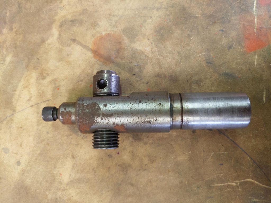

Philip O'Brien08/05/2020 14:12:31
3 forum posts
1 photos
Hi,
Can anyone tell me what this tool is used for and how it is used. It came with a Denford Viceroy lathe.
Regards
ega08/05/2020 17:19:56
2805 forum posts
219 photos
Posted by Philip O'Brien on 08/05/2020 14:12:31:
Hi,
Regards
It's a woodturning tool. The hollow ring centre locates the work which is then drilled with a special drill worked through the centre.
