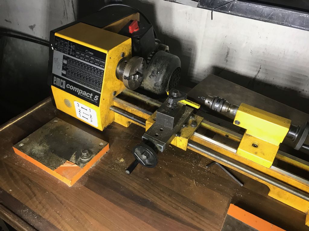

Hi I’ve recently acquired an EMCO Compact 5 lathe - see photo. I’m not an engineer but a retired pen pusher and know nothing about lathes. Is the EMCO Compact 5 a good lathe ? What’s an approximate value? What sort of work can it achieve? Thanks01bfe434-b606-43d7-a521-4160fa1da1e3.jpeg

Hi William,
Congratulations with your "new" lathe. I have got an old Emco Compact 8 lathe (a bit bigger than the Compact 5) and it has served me well for decades, if the Compact 5 is not worn/damaged you should be able to achieve good results. I don't know if you have the manual, if not it seems it can be downloaded here.

Great little lathes and very well made, I used one for years. Value is very difficult to say since condition is the main thing, but one in very good condition could fetch £500 I would think.

Never seen let alone touched one but EMCO were a popular make. (The company is still active, but they don't sell this sort of machine any more.) With old lathes condition is everything; many are cosseted, others were thrashed, abused, worn-out or stored in a puddle. They can be anything between 'as new' and scrap.
The best single advice I ever got from the forum was to buy the biggest lathe you could afford. It's because a big lathe can do small work, but a small lathe can't do big. But there are strong arguments against if the lathe is only needed for small work and you need a quiet unobtrusive machine. The EMCO is dinky: think clocks and model railways rather than motor bikes!

Hi William, I guess it all depends on what you mean by a 'good' lathe. My view, as an owner of one, and several other lathes, is that it's well made, but is very limited. It has a limited range of speeds, the slowest making screwcutting a bit frightening, and making turning large diameter ferrous pieces difficult. Also, the saddle and cross-slide are not particularly well-designed. Having said that, used within its limits, it can be accurate, and a pleasure to use. A lot of users are well pleased with them. I think that if you learn to turn with one, you will gain skills that stand you in good stead for when you get a more grown-up lathe. Sharp tools required!
You probably know they are no longer made. However, www.emcomachinetools.co.uk can provide some equipment and spares. www.emcoshop.at have a larger range of spares. You might consider the auto-longitudinal feed attachment.
Good luck. Enjoy!

Since you've also got the Myford Super 7 you mention in another post, if you intend to do any machining with either of them, the Myford is *probably* the more versatile and flexible to keep - assuming you can get it running and have the space.
There was a time when I had the Compact 5's smaller cousin, the Unimat 3. That was also a well-made machine, though tiny, and I wished I had the space and cash for a Compact 5. Now I have a Sieg C0, a Unimat 3 clone, for when I have a small turning job and don't want to disturb a setup in my main machine. I don't know that clones of the 5 were ever made, though it's a well-regarded machine for its size.
A couple have gone on the Bay this spring for prices of £302 and £330, though dealers would probably charge more.

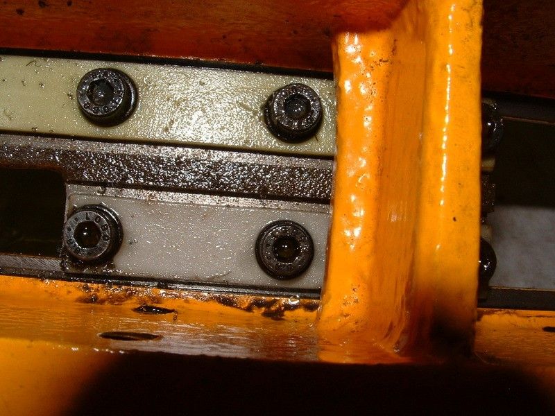

z+axis+gibstrips.jpgWilliam
If you are able to lift the saddle from the bed you may need to fit some new gib plates, or just remove and refit the existing ones by turning over end to end to use the unworn surface.
This will normally improve the performance of the lathe and is best to stand the lathe on end to gain access to the M5 socket caps retaining the gibs.
Did you get the chuck key ? if not a Jacobs K3 will fit if you turn the spigot to fit the chuck, also you need to extend the length to give working clearance.
I guess you know the chuck jaws are reversible, the relation of chuck jaws is the numbered sheet on the lathe headstock.
