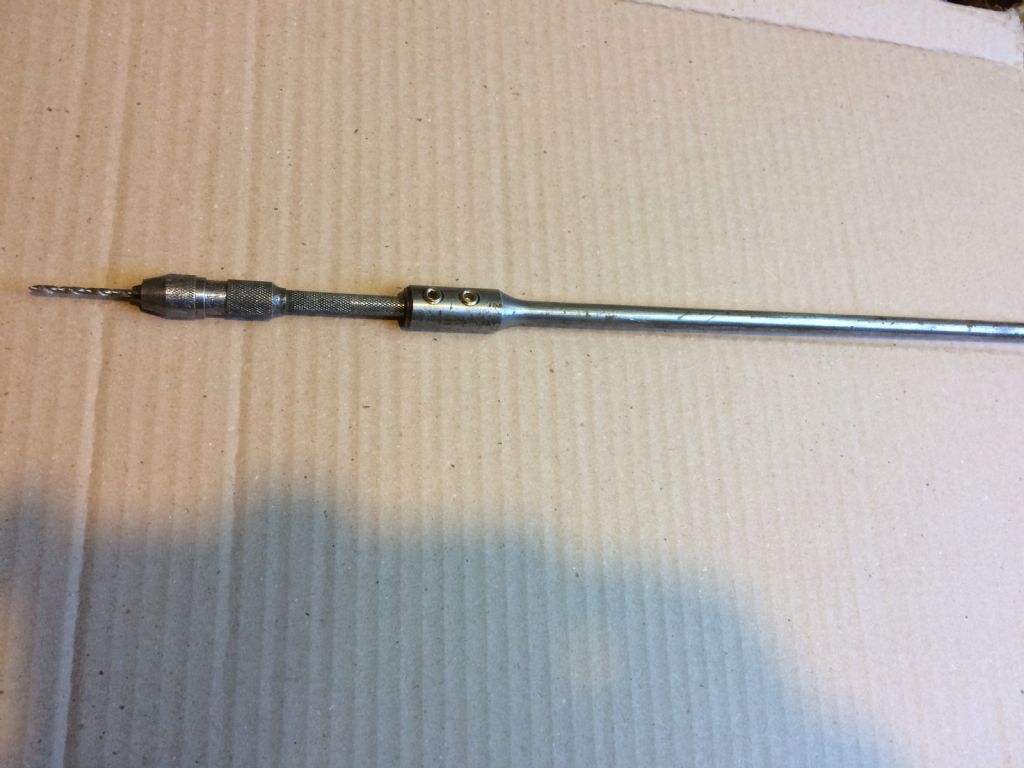

I had an interesting problem the other day, Needed to drill a 1/16"hole down in a deep pocket. As per usual, I had the small drill mounted in a pin vice, but was still a few inches too short. racking my brain for a quick soloution, I mounted the pin vice into a Wood Bit Extender. Worked perfectly, perhaps a bit wobbly, but it did the job.

Hi nothing wrong with using a wood bit extender if you have one, very good. If you havn't you can always use a piece of silver steel drill the end for drill size and loctite the drill in the end. You can always do the same for taps to tap down deep holes.
