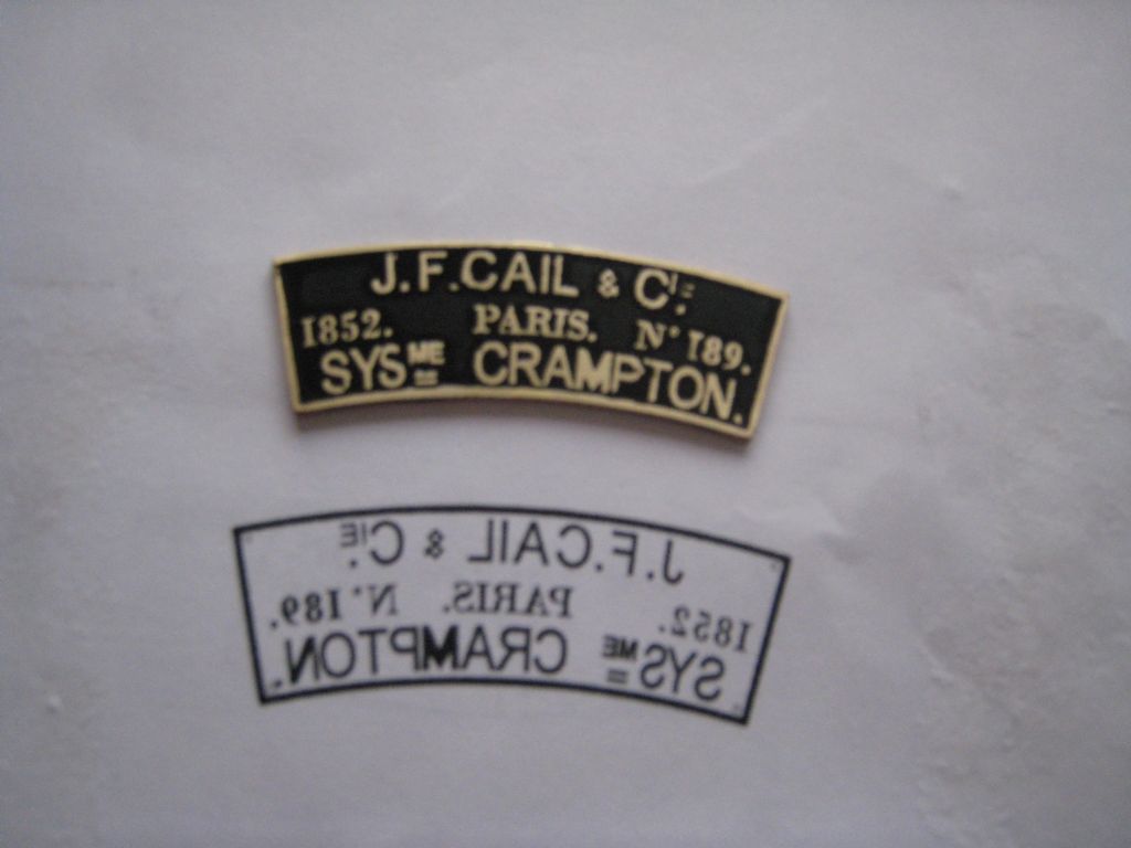

John Rutzen14/03/2019 14:18:39
411 forum posts
22 photos
John Rutzen14/03/2019 14:21:30
411 forum posts
22 photos
As you can see the result isn't professional quality but it's adequate for my model. My son did the artwork on Autocad but it took him a long time and he's good at it!. Unfortunately the only way we could reverse it and get a negative was by taking a screenshot an using that so we lost resolution.
SillyOldDuffer14/03/2019 15:04:00
10668 forum posts
2415 photos
Posted by John Rutzen on 14/03/2019 14:21:30:
Not sure about AutoCAD, but most CAD tools create text in blocks of fixed characters specifically so you don't get a negative when you mirror the block. It ensures text always remains readable, which is usually what's wanted.
Everything else can be mirrored, and an efficient way of producing a symmetric object is to draw one half only and to create the other side with a single mirror command.
To produce a true negative of a word you have to first select the text and Explode it . (Explode converts complex objects like text into their component arcs and lines.) Once broken into parts, reselect the whole lot and mirror that. As the components are now ordinary arcs and lines, they should mirror as wanted.
Of course once text has been exploded, you can't edit it as text any more. Double check spelling!
