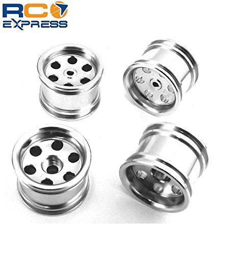

I have a small RC Model that I would like to make some aluminum wheels for..
the original plastic wheels have a 2mm hole in the middle that has a flat spot so its a D shape for mounting and taking the drive..
what would be the best way to make this D shaped hole?

Make a small broach and drive that through an undersize hole

Posted by JasonB on 07/01/2019 07:02:12:
When I've thunk that thought in the past, I've doubted that it would work because of the asymmetric side-forces on the broach messing up the concentricity.
From the pics of your swarf, it looks as if it works pretty well. Thanks, I'll file that for future ref! smiley

Mick, it did wander off slightly so best to do the broaching first and mount on an arbor to complete.
Having said that it was only a quickly knocked up broach to see if it would work and I just squeezed it in with the bench vice, a better made one and some care ensuring it is true when pressed would give better results. It came out so well I did not bother with a better version just use the test piece.

Another option may be to just put a 2mm hole right through then cross drill 1.6mm to meet the 2mm hole. Part tap that M2 and then make a small steel screw with 1.6mm plain end and M2 thread with a screwdriver slot in the end.
Slip the wheel onto the stub axle, start the screw then put a small amount of Loctite onto the thread before screwing in until it just nips the flat of the axle. once the Loctite has dried you can slide the wheel on and off as needed with a fitted tyre, pin will stop it rotating.

That's also a good idea and probably the easiest to accomplish I should think
