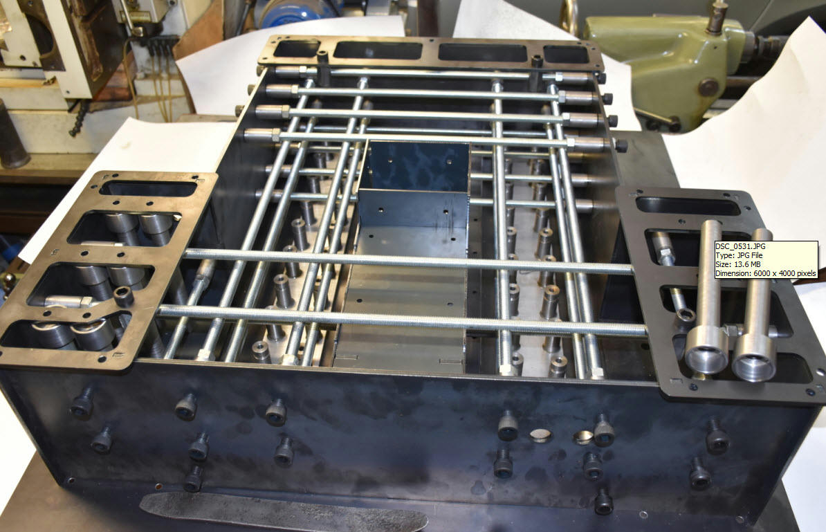

As the cross member will be cast first it is a good time to review its components
The cross member has a volume of 0.02 cubic metres The granite and silica sand aggregate used weighs about 2200 KG per cubic metre therefore the epoxy composite material used should weigh about 44 KG add to this the steel parts and the component will weigh maybe double that. When I have the time I will compute the steel. Autocad does not do this automatically I have to do it piece by piece.
Cross member see through view
As mentioned previously built in jacks are used to position the cross member before it is epoxy/metal powder grouted in position. See red arrows below
Side View showing jacks, also the joint between the columns and the cross member, green arrows and purple and green lines. It is between these lines that the grouting will be inserted after the machine is aligned.
Alignment jacks red arrows oblique view.
Also note Left limit switch Right switch not shown. They sit in laser cut protective housings. The switches are moderately priced standard industrial micro switches, rated for millions of operations.

This week I purchased 20 litres of Megapoxy H This was the epoxy I used to make the Epoxy Worden Grinder I made about 7 years ago. and published on this forum. The spec sheet for Megapoxy can be downloaded from their Australian website. I have no connection to the company apart from being a satisfied customer. Yes I am very happy to recommend them they have been most helpful.
For other countries there are many companies that will offer a similar product. look for an epoxy with similar physical properties and make sure it does not contain solvents. As the name suggests solvents evaporate causing shrinkage, we do not want any mold shrinkage.
To see the casting process page down a little here: **LINK** This project was made some time ago using a simple MDF mold.
Why is it that the weekend is not long enough! I had planned to pour the first casting however the few loose ends to tidy up grew. Much progress has however been made, the mold plates have been covered in plastic sheet that was in stock. Ignore the age spots, aAlso some components have been wrapped in silver vinyl duct tape. this will form a barrier stop the epoxy sticking to the steel. Before the pour the mold will also be coated with mold release
Cross member mold assembled 98%
As above inner frame removed

I provided for embedded 20mm PVC conduit to carry the y axis servo encoder and drive and the Y axis limits in the base mold. it connects to the control junction box noted earlier in this thread.
Thanks for reminding me to do it for the cross member limits, that list just keeps growing......
Aqua blue lines are the mold.

The swarf guard blinds are supported by the top of the linear rails as well as at the edges, There is also a lip at each end of the table to keep swarf out. in combination with the blind the mechanism should remain pretty clean.
This is where CAD comes into its own, every part given its own space, and not much more.
