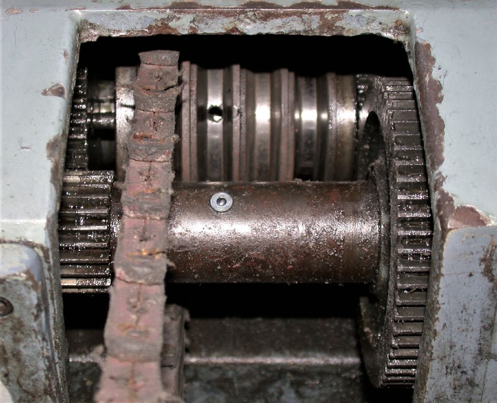

Its oil in all the ball nipples. and grease in the 2 headstock points. I see your headstock has a nipple for the grease at each end of the front of the headstock. I have only seen Boxford A s that have a grease cup in theses locations. With these you unscrew the cup, fill it with grease, and screw it back on, so forcing a measured amount of grease into the spindle bearings.
As you are using backgear there is an important lubrication point which is not obvious and is accessed from the rear of the headstock. You can see an oil ball nipple in the middle of the shaft carrying the backgears at each end, but there is also an oil reservoir inside the 5-way pulley cluster. This is accessed via a grub screw in the base of the second groove in from the chuck end of the spindle. The grub screw is removed and oil put in until the reservoir is full, and the screw replaced. This is an important part of the backgear procedure, as the pulley cluster is deprived of the support of the bullwheel when backgear is used.
Boxford list a variety of oils and greases, most of which are now out of date, but ultimately a standard SAE 20 mineral oil (as mentioned by Johnboy25) and a general purpose bearing grease are adequate.
Picture of the rear of the headstock showing the oil points, the grub screw has been removed to make the hole easier to see. (BTW I do have a new link belt to fit eventually!)
