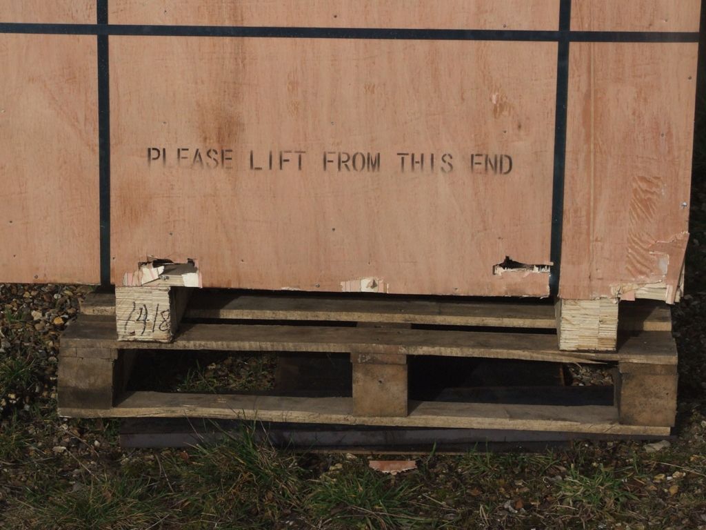

I have recently taken delivery of a Tormach 1100. It came on a truck, on a pallet, with the create of wood the machine was bolted into on top of the pallet. Neither me nor the delivery guys had any simple way to lift the machine and get the pallet out from under it.
In every delivery video and photo sequence I've seen, no-one else has had a pallet under their machine - just the piece of wood that forms the bottom of the crate!
Tormach (and others) show how you cut down the wooden base to fit a parallel legged engine stand in there to lift the thing.
I couldn't do this because I'd have to cut a shipping pallet and the wooden crate base.
It was a hell of a performance involving false raised floors, jacks, and all sorts of other nonsense to get the damned thing off this double height, too wide, platform.
Has anyone else been left with a pallet under the crate to contend with?
Even better, the first one was delivered broken which I didn't notice until it was on the stand! So I had to get it off the stand to the floor, repeat the whole performance with the new one, then get the broken one back on the double height base... I was thoroughly sick of the sight of both of them it by the time I'd finished. And it's still taking up a quarter of my workshop waiting to be picked up.

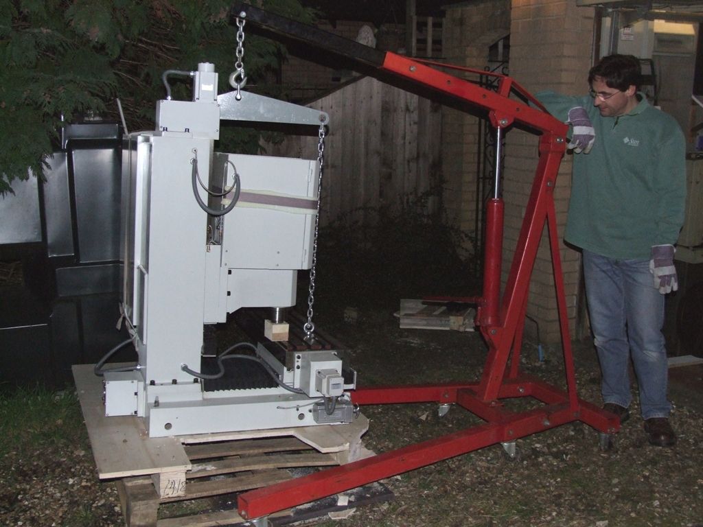

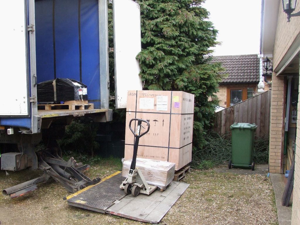

You're not alone! My Tormach came on a pallet:
In hindsight it would have been better to ask the delivery driver to drop off the back of the lorry on the opposite side to that shown. At some point during shipping a forklift driver had a wobbly:
Fortunately no damage done inside. It was a right royal PITA getting the mill out of the crate and off the pallet. We had to do a lot of sawing and then a 2 ton engine crane on it's longest extension (500kg) just reached:
Along with the mill I bought the Tormach lifting bar and chains. I figured that if I dropped the mill with some home bodged arrangement I'd be on my own regarding warranty. So better to use the official gear. Later the engine crane just had enough height to lift the mill onto my homemade stand:

David Taylor21/08/2018 11:54:35
avatar
144 forum posts
39 photos
Thanks Andrew, very interesting.
I see you too have the splay legged engine lifter, although mine is only rated 1 ton with 250kg at the longest extension.
So you did just chop the pallet to pieces. Well done How did you get over the gravel and up the step into your garage? I had a similar problem, solved by a chain of phone calls to strangers ending at someone with a bobcat with forklift tines on it. Who offered to come around immediately on his way to another job!

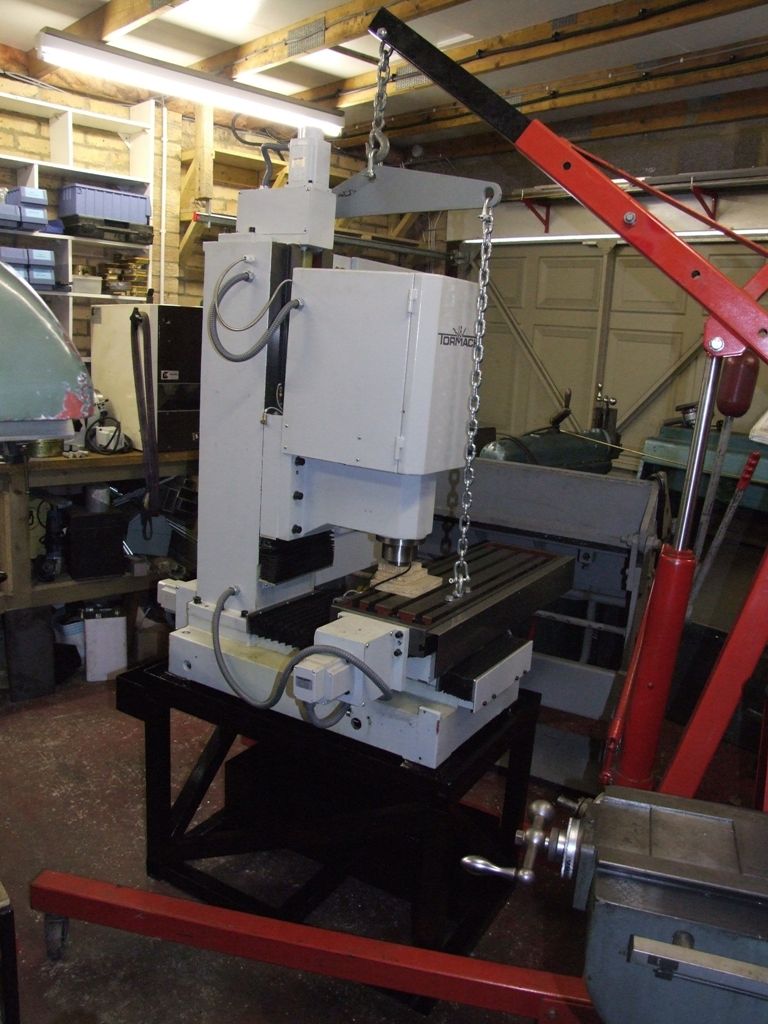

Is that chain going into the T-slot? Doe sit have a long T to spread the load. Anyway interesting they confirm it is strong enough to take half the machine weight.

Posted by Bazyle on 21/08/2018 12:39:25:
I had to go and have a look. The T-nut is about 2" long with a tapped hole for a lifting eye. If I recall correctly the T-nut was quite a snug fit in the slot. But the mill isn't that heavy, about 500kg.

David: The engine crane isn't mine, it was borrowed from a friend. Afterwards I broke up the pallet and case and recycled the wood and nails. Getting it across the gravel was a PITA. We had to swing it between the legs of the engine crane put it down and then move the crane a few inches at a time. That's why it would have been better to have had it dropped off the other side of the lorry. In the first picture bottom right there are some large hot rolled steel flats propped up. They were used to roll an 18" shaper out of the garage so we could get the mill in. We certainly deserved a beer by the time we finished.
