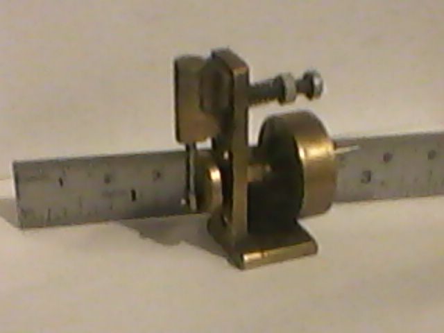

Heres a little one that I had in a little tin boat, it could manage a trip up and back on the lake at the local recreation centre. The boiler was a 40 mm dia bit of copper tube about 60 mm long, just as it got to the end of the voyage, the solder holding the steam pipe from the top of the boiler melted, boiler dry. It got sailed a number o times after that. Ian S C001.jpg
