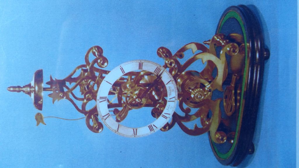

1 Showing popular clock designed by John wilding

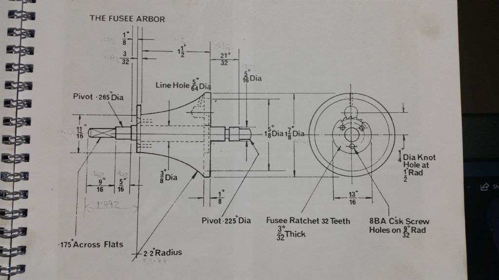

2 The dimensions of the fusee from the book by John wilding.

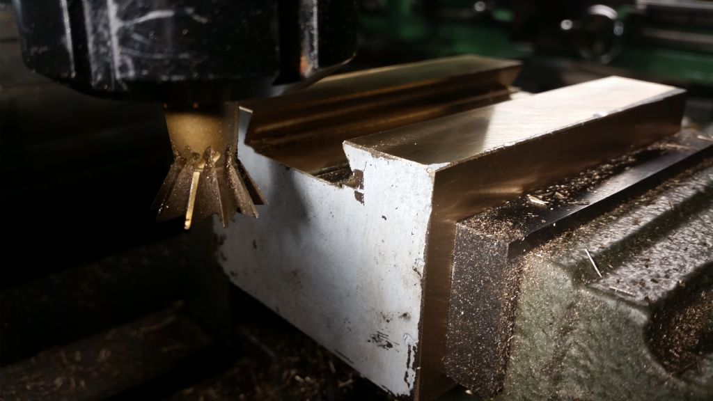

3 Cutting the dovetail to mount the block onto the taper turning attachment.

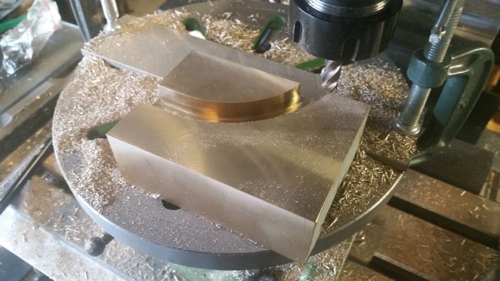

4 Cutting the radius for the roller guide.

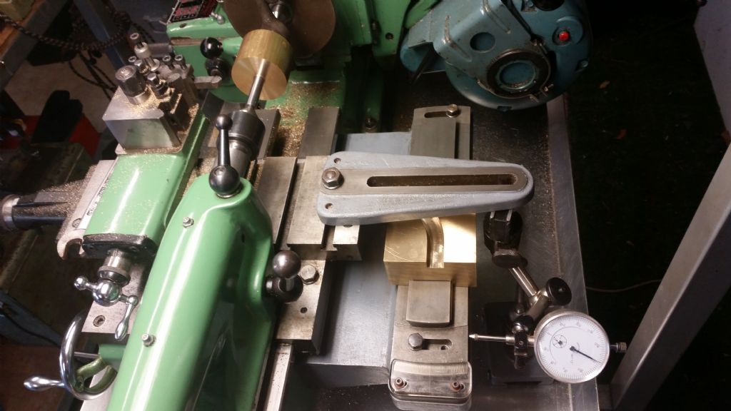

5 Setting the attachment with the dial indicator.

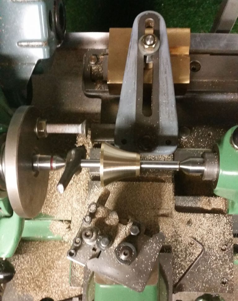

6 Showing the first few cuts of the fusee

Photo from above, now right side up....wink 2
