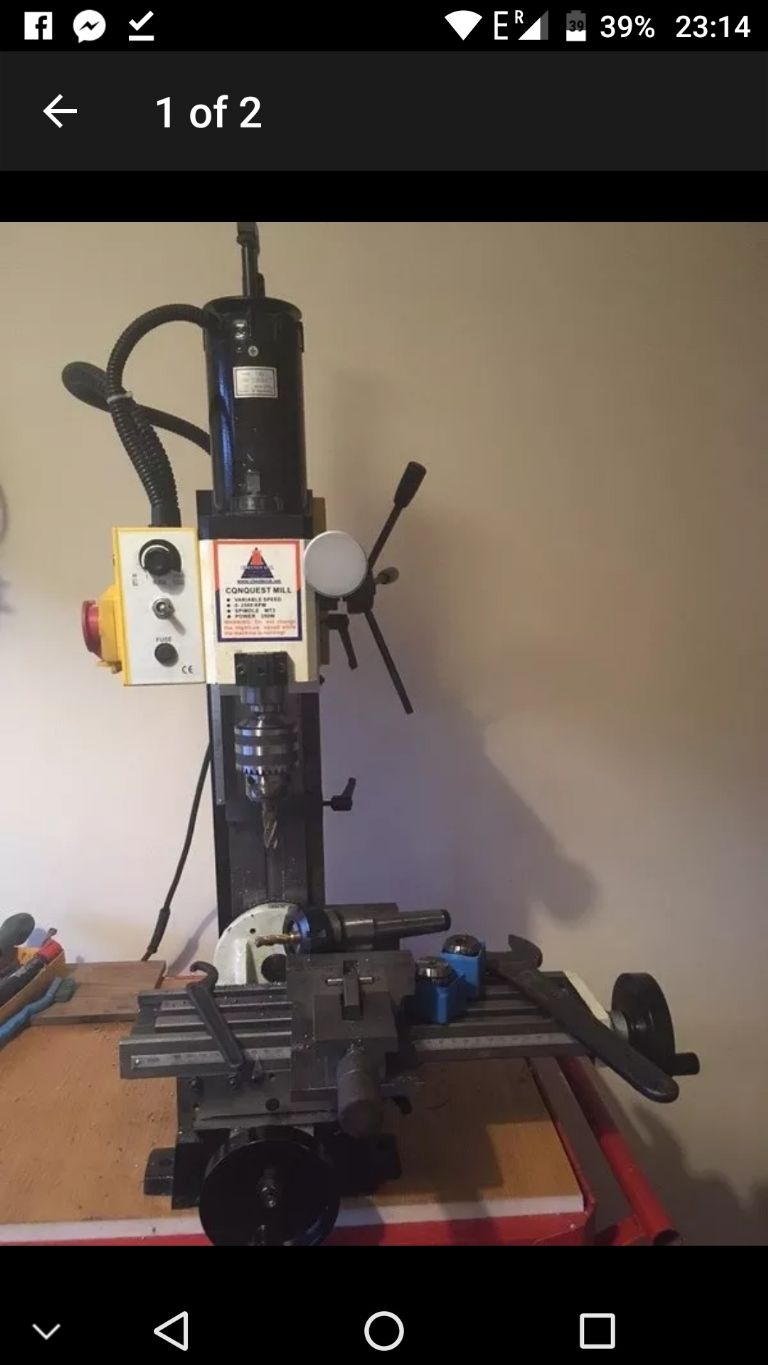

Hello everyone. Im just after buying a secondhand chester mini mill (x2).could anyone be able to answer a few questions I have with this mill? Its an x2 mill with a tilting column. Has a gas strut, 130mm x 300m travel. The motor is a 350w version with a xmt 2335 control board.
1. Can the solid column sold by arceurotrade be a direct swap or will the dovetails need machining to fit. Or would I be better off just making up a bracket to lock the column and brace it.
2. Is it true the 350w is hobbled by the control board so it won't break the gears. If so are there mods that can be done to get the the full power for the motor.
I'm planning to get a belt conversion.
I'm mainly going to be using the mill for motorcycle stuff. So I'd like to be able to fly cut and hopefully be able to make 1mm DOC in steel.

1525460599781.jpgAlso I'm missing the left hand side table cover plate. The previous owner took it off and lost it. Was easier for him to clean chips out of the table. Was this plastic or metal??

Ketan Swali04/05/2018 21:35:39
1481 forum posts
149 photos
John M,
Your comment: 'I noticed all the gib strips where not machined correctly for the gib screws , so I'll sort that before I put the table back on'
My suggestion: make vertical slots where ever the dimples on the gib are. This will allow the grub screw to locate more easily in the slot rather than a dimple which may be higher or lower than the centre of the gib. If this fails, then you can consider re-drilling and tapping new holes in the casting, next to the original holes.. more in line with the centre of the gib.
Your comment: 'But I'd imagine it still would not be as rigid as the solid column'
The tilting column box section is between 4mm to 6mm thick. I designed and commissioned the fixed column, originally as a component to make the SX2P, which I wanted made. The fixed column is approximately 10mm thick box section. It was designed by me, drawn up by a wiz SIEG mechanical engineer-designer on some sophisticated CAD within 30 mins... then it took a further days convincing and negotiating with the GM, to make. So, the answer to your comment is - YES - the fixed column is rigid.
Your comment: 'What can these little mills DOC be in steel and aluminium? With let's say a 4 flute 10mm end mill'
The DOC is dependent on various factors, based on your motor/torque/hi/low gear in your case, feed, speed, cutter grade/quality/coated/un-coated, quality/grade of material being milled, with or without coolant, and finally what your expectations are. It is a process of experimentation
Generally, I would start experimenting with 0.5mm depth for Steel, 1mm depth for Aluminium, checking the feel and finish, and then proceeding to deeper depths between 1 to 2mm for Steel and 2mm to 3mm for Aluminium, and so on, depending on factors mentioned above. For a more qualified idea, you would need to get a response from real users, such as Neil and Russel, who have similar or variants of SIEG mini-mills. Neils machine has the same motor as yours I think.
Regarding the table end cover plate, although I have not come across your table version, if the right hand side plate is metal, then the left hand side will be metal.

Ketan Swali04/05/2018 21:42:39
1481 forum posts
149 photos
John M,
Looking at the picture of your mill, I am not sure but it looks like you have a milling cutter held in a drill chuck. If this is the case then it is a bad idea holding a milling cutter in a drill chuck. If it is a drill bit which you are holding in a drill chuck, then my observation is retracted, and maybe I need new glasses. teeth 2
Ketan at ARC.

Hi John M. I have a Chester Conquest mill. It too has the bigger table on it. I have fitted a 2 pulley drive belt system. It works a dream and also gives the option of 2 speed ranges. The table end plate should be metal and contains a bush to hold up the lead screw. As for the column, I have had the machine since new and apart from resetting the vertical tram when I got it I have had no further problems of alignment with it. I might get to make a strengthening bracket one day. I have made a lot of items including 8 BXA tool holders and all the parts for my dividing head without any problems. BUT remember it is a small mill so be conservative with the cuts you take. I have used up to 20mm cutters despite all the comments across the web that this is not possible. It all depends on how you treat the machine as far as I am concerned. I have fitted mine with 3 axis DRO and power table feed & rev counter.
All in all an excellent little machine but I do now have a larger mill for bigger jobs but the Chester is my go too machine for most things that I do.
I agree with Ketan, do not hold cutters in your chuck when you have a collet chuck lying there

Dennis R04/05/2018 22:54:50
76 forum posts
16 photos
Hi John M
It appears from your picture that the ER collet chuck, with a milling cutter in, does not have the collet correctly inserted in the collet nut. If that is the case the collet will not self extract and the cutter may not run true.

John Murphy 305/05/2018 02:23:29
17 forum posts
4 photos
Ketan, again thank you for the lengthy reply , if I could take 1mm in steel I will be very happy. Regards the drill chuck and collect chuck. That is the pic that was used by the seller in the for sale add. I'll post updated pics tomorrow and I'm aware of the basics with milling. I have an ML7 lathe in which iv done milling with. I was only able to take .2mm doc so if I'm able to take 1mm in steel that would be great. Ketan do ye sell those end plates on the tables? Old iron , by the sounds of it I'll be very happy with this thank you for the info.
