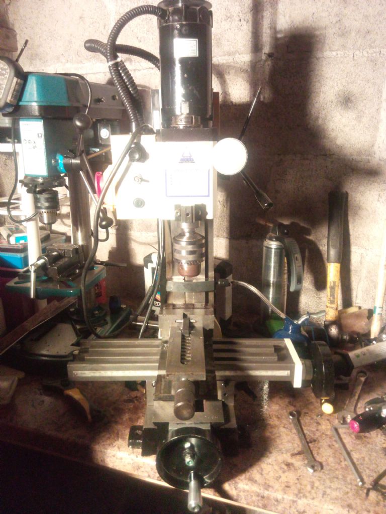

As you can see from the video its off quite a bit fwd and aft. The starting point at 0 is also just about 0 when I swing it over the other side of the table to check the tramming. It was way out before I reset it. Also the end of the video I'm putting pressure on the head and also pushing/pulling the column. That's the amount of flex/movement. The head gibs where locked and also Y where locked.
How do people adjust fwd and aft ? Shim the head or the base of the column. Also any idea why its flexing so muchhttps://youtu.be/xmvdDNTE0ls

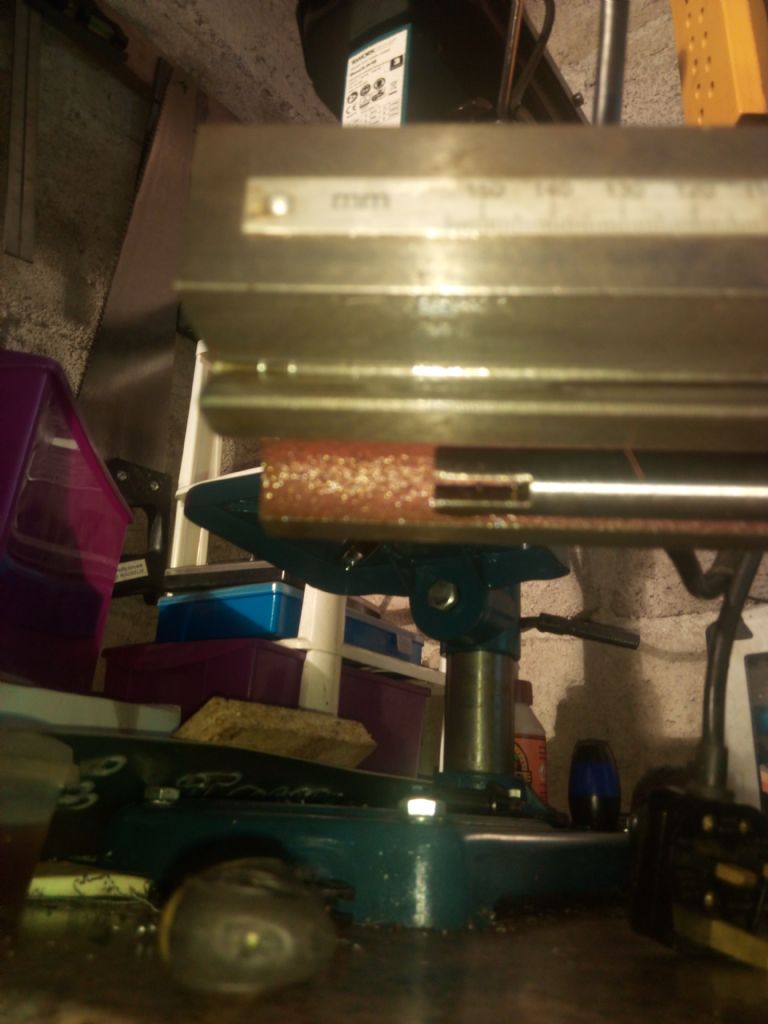

Old Iron thanks, yes I'll make something up on the lathe. Was curious if they came that way originally. I'm nearly sure it came with a plastic cover plate , makes sense if the lead screw wasn't even supported.
Tramming the machine at the moment. Noticed a lot of flex fwd and aft pulling or pushing the column. I'll try get a clip of it later. How do you tram them fwd and aft ? Shims ?

As it stands of last night, crappy quality pic. I really like this idea in the link(what Ketan said). http://robertsprojects.blogspot.ie/2013/04/mini-mill-solid-column-conversion.html?m=1
Just attaching the column. Only problem I see is trying to figure out how to mount the base in the ML7 to machine the rear of the base flat lol. I made a quick wheel handle for the Y as it was missing. Also need bellows and a gib lock for the X. I need to take the gib out of the Z and have a look at that, then its tramming everything and make some cuts

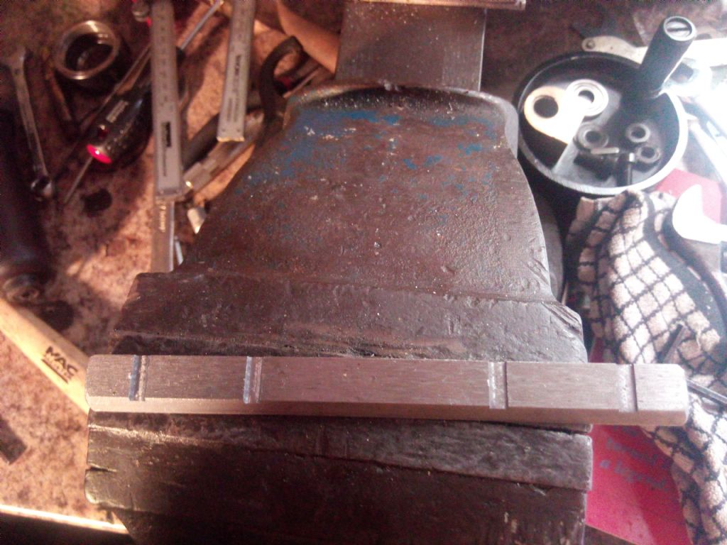

The more i think of it i Should of just plunged cut a slot instead of milling a full slot, but it seems to be fine and feels better than it was.

Thanks very much for the all the help guys , I milled slots in the gib strips and it helped quit a bit. Looking at the base of the mill it looks quite easy to make up an adapter to fit a solid column and I think that will be the route I will take after I use the tilting column for a while. 1525540337175.jpg

1525460599781.jpgAlso I'm missing the left hand side table cover plate. The previous owner took it off and lost it. Was easier for him to clean chips out of the table. Was this plastic or metal??

No I bought this machine second hand cheap. Seems to be in good condition. I have the table saddle etc removed to check things . I'll remove the head tomorrow and check that. Yes ketan that was another option i was thinking , I could just make up an adapter and fit just the column. I noticed all the gib strips where not machined correctly for the gib screws , so I'll sort that before I put the table back on. I see ye sell the sx2l base as well. I have a scrap bit of c channel steel in the garage. Make up a brace and see what its like. But I'd imagine it still would not be as rigid as the solid column due to the increase of thickness but also even the braced tilting column still has that crap bolt going throw it Really bad design. What can these little mills DOC be in steel and aluminium? With let's say a 4 flute 10mm end mill.
