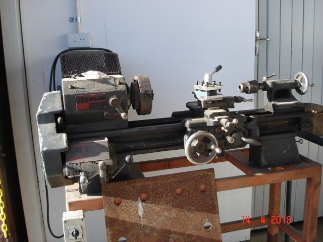

Went back to the local Men's Shed today to do a bit more toward getting the Boxford A up and running. Problem; the 4 jaw chuck is stuck in place, it;s got to come off. The chuck it's self is damaged, 3 out of the 4 square key holes have a side out of them.
I'v got a copy of a hand book off the web, and their suggestion is to lock the back gear, put the key in the chuck, and give the key a bump with your hand. I prefer to put a bar across the jaws and tighten the jaws on it, and I tried that to no avail, what next?
Another wee problem, how do I slacken off the belt, it's go something to do with the lever just to the right of the thread cutting gear box, I think the set up is a bit of a lash up, the hand book shows the jack shaft tilting via a lever from the top of the head stock, but it does not show the above mentioned lever by the gear box.
Here's a photo of the machine.

Hopper01/05/2018 11:27:08
avatar
7881 forum posts
397 photos
Be careful using the backgear to lock the spindle if the chuck is firmly stuck. Busted teeth have been done that way before!
The time honoured method instead is to use a bit of impact by the placing of a block of wood between chuck jaw and bed, with top of wood at about centre height. Using the countershaft pulley etc to spin the spindle by hand in the reverse direction, give it a good quarter to half turn to build momentum before one of the chuck jaws smacks into the wood block. This should free the chuck in most cases.
If not, you can try the same process but under power in the lowest backgear, if your motor has a reverse switch. Keep fingers clear etc etc of course. I've never had one stuck so tight I had to go this far but it is recommended on lathes.co.uk so perhaps not as barbaric as it sounds.

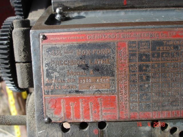

Here's the data plate, sn., 2355 A 367, has some got a clue to the age of the machine?
Ian S C
Jon Gibbs02/05/2018 16:28:10
750 forum posts
I'd guess it was made in 1950... **LINK**
Jon
