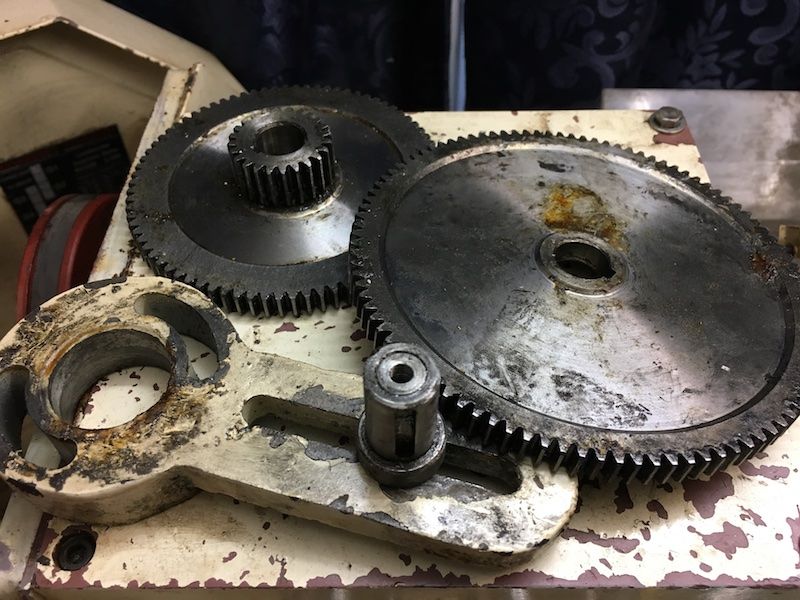

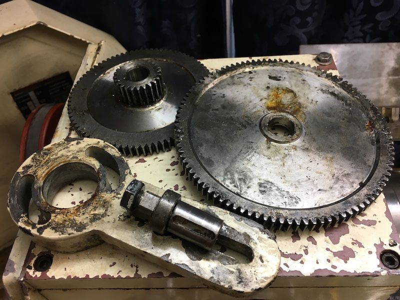

I have an Axminster mini lathe that stoped working this morning. The motor was running but the chuck wouldn't turn. Like it had stalled.
I started to investigate and found that if I removed the large gear that sits between the leadscrew and the driven gear the chuck would turn as normal.
I found that the gear off the quadrant would not rotate on the shaft. (See picture of shaft below) It screws into an arm that is bolted around the lead screw shaft.
I'm assuming that's a bearing on that shaft under the gear and that it is seized?
If it is a bearing does anyone know where I can get another and how I get it off?

After a bit more research it seems it's a bush on that shaft and that is what has seized.
I may try some heat to see if I can remove it that way.
I can order a new bush but the shaft is out of stock. Ideally a new shaft and bush would put it all right.

Thanks for all the replies. Arceurotrade do in fact list the parts. The bush is in stock but the shaft is not.
I think I'll try the PlusGas route before ripping into it it with something that may cause damage.
I suspect you are right when you say the bush has been allowed to run dry. Won't let it happen again once I've sorted it.

If it was mine, I would refit the stub shaft in the arm, secure the arm in a vice with the stub pointing upwards, replace the big gear on the bush with the key in place, then soak the bush with Plus Gas and try to turn the gear back and forth. The extra leverage gained by gripping the rim of the gear could be enough to start it moving, then it's just a matter of time and perseverance . . and plenty of Plus Gas . . to get it spinning freely.
If that doesn't work first time, leave it overnight to soak and keep trying. I've freed up many old bits of machinery using similar methods. I would only use heat as a last resort.

Just be careful if you use the sector arm as a wrench - Its probably made of cast iron (or even aluminium) and will easily shatter.

I think Arc and Axminster are SIEG but I'm sure taht banjo is not for an (S)C2/3

I mistakenly assumed that it wasn't from a Sieg because as Neil has pointed out the banjo is different from that on my SC3. Apologies.

Hard to be sure from the picture but it’s looks a little like my BV20 Lathe.

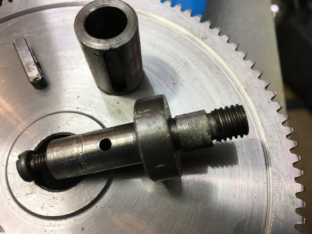

Putting the gear back on, holding the assembly in my vice and wiggling vigorously worked after a soak in PlusGas (There is no other penetration fluid and don't say WD40) haha. Thanks Mike, good suggestion.
As you can see from the attached photo the shaft is quite scored as was the centre of the bush.
I started gentle, cleaning with a fine wet and dry. That had an effect but didn't allow the bush to run clean on the shaft. So, having cleaned the shaft of any burrs and high spots I put the bush in the lathe and using a very small boring bar I reamed out the centre by a really small amount.
That had the desired effect and everything slid back together smoothly, with the addition of some horrible think black Moly grease it all works fine.
I say fine, I still intend to purchase a new shaft and bush when they are back in stock.

Oil is to be preferred to grease around the change wheels so that it doesn't build up the swarf into a grinding paste. Easy to wash off periodically. Since the gear on the bush will get changed relatively often a hole in the middle that encourages you to squirt oil into the middle pushing out old oil each time you change it will help.
Jeff Dayman02/04/2018 15:44:44
2356 forum posts
47 photos
Mick - the hole for the screw shown in your photo - does it connect to the cross drilled hole? If so maybe you could make an adapter with same size thread as the screw to go on your oil or grease gun. That way you could pull out the screw and give it a fresh shot of oil or grease periodically. It will probably never seize again if you did that.
If the holes do not connect maybe you could drill end hole through to cross hole so it does, or drill and tap the other end to do the same idea.
