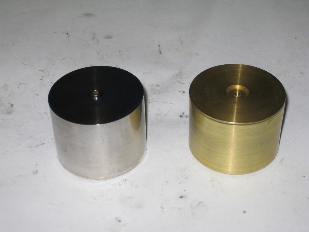

steamdave01/04/2018 10:26:02
526 forum posts
45 photos
Following on from JB's suggestion, I turned up a new displacer piston from 316 stainless steel. I was aiming for 10 thou wall thickness, but it turned out to be more like 8 thou when finished and the top even less.
The original displacer weighed 93 gms and the new one was down to 34 gms - quite a saving, and hopefully the heat transfer will be a lot slower, enabling the Robinson to run for a while without external cooling.
In the end, I decided against a regenerative displacer, as this one seems to be a great improvement on the original brass one.
