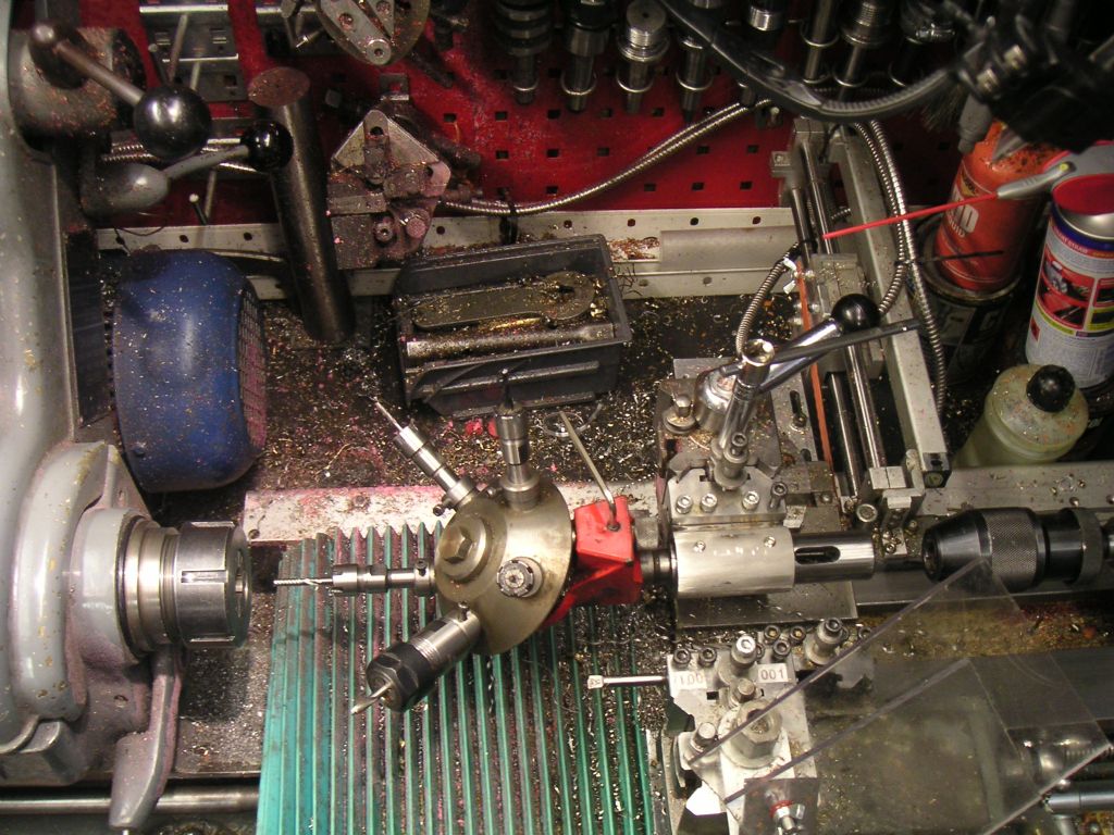

If you mean for drilling, yes, you can buy or make MT2 adaptors for QCTPs

Nick Hulme18/01/2018 16:24:49
750 forum posts
37 photos
While it is easy to fit a cheap and cheerful DRO-alike-thingy to the tailstock that doesn't resolve the issue that the tailstock travel can be quite limiting for some jobs, although my picture above shows a turret in the MT2 holder I built it to allow me to drill and ream holes which exceed the tailstock travel.
- Nick
