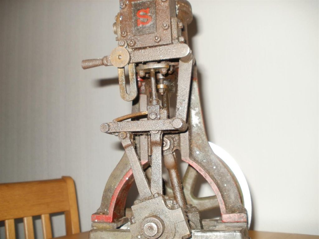

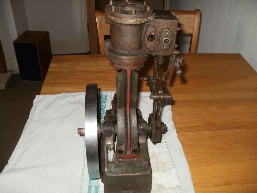

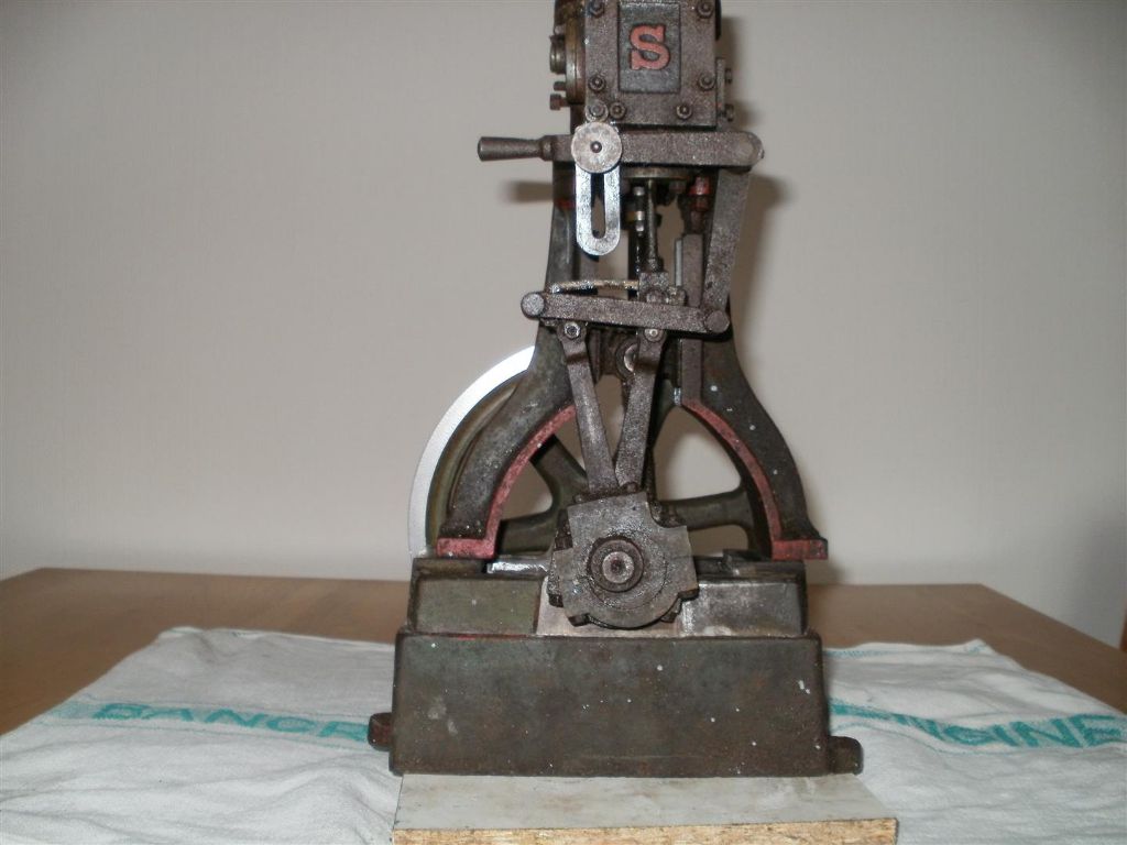

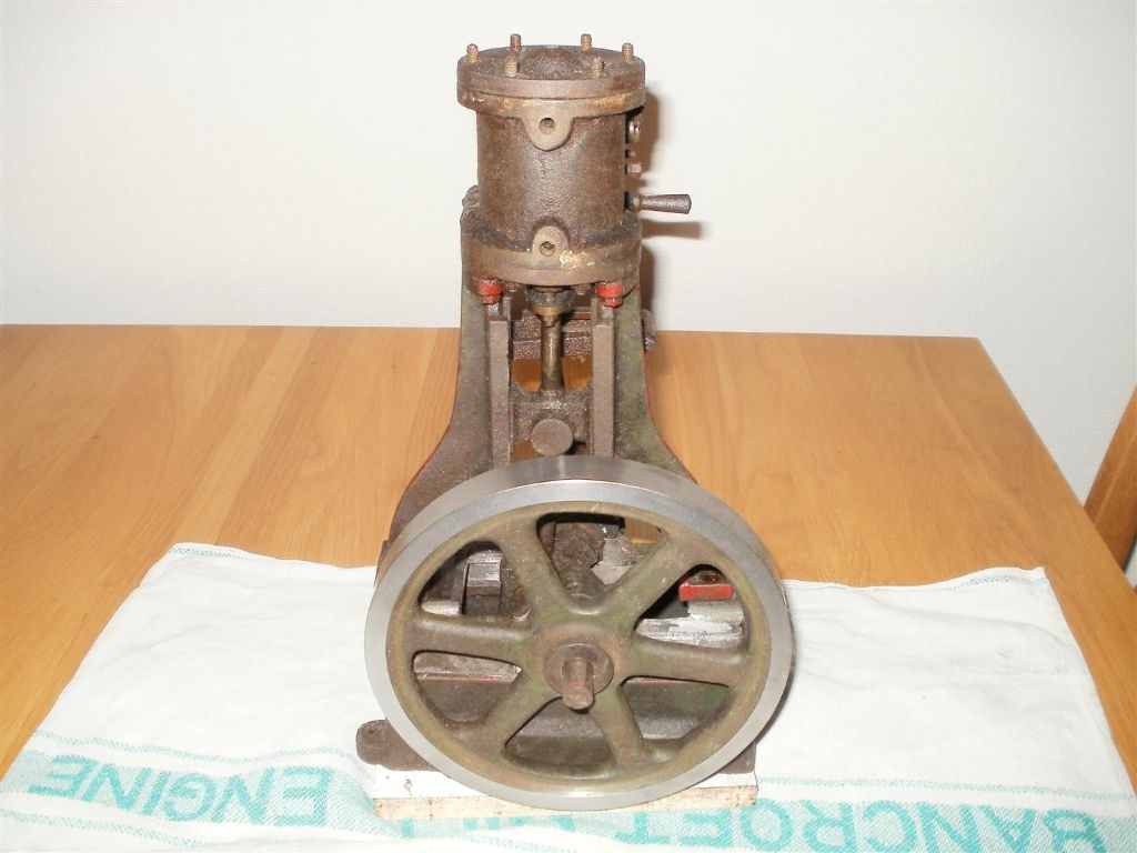

pb261860 (large).jpgpb261862 (large).jpgpb261867 (large).jpggood Morning.
Can any body help to identify this Stuart Turner engine.?
It's 13 1/2" high, 2" bore & stroke with a 7 1/2" fly wheel..
The steam inlet and exhaust are on the same side of the steam chest/cylinder..
The cylinder bore/stroke would suggest it's a number 1 but as you can see it has two separate vertical standards with the piston rod/ crank small end guide running between them.More photo's in my Stuart Turner album.pb261853 (large).jpg
As you can guess it's a restoration project!
Thank you.
Ian

Hi Ian ,
​Looking through the Stuarts catalogue I would suggest it is a No1...with a modification to the frame work & reversing gear added...

Ian.
I do not have my early Stuart catalogues ; my son seems to have them for some reason. However what you have is probably an early No 1 engine, and by early I mean pre WW2. I seem to remember that these machines had two cast standards rather than one standard and a support column. When I lay hands on my catalogues I will have a look.

As Michael says I have seen other early No1 engines with the two part standards like yours, think they may well be pre WW1

I agree; it is an early No.1 It would be interesting to find out how early. I have an old No.1 that I restored, with one standard and a steel column, the same as present day. All the threads are Whitworth. I called Stuart Turner, and they said that they changed to B.A. threads in 1918; so I think it reasonable to assume that mine predates this date, and that Ian j's engine even older than that. It might be worth contacting Stuarts to see if they can tell you when the design was changed. They were most helpful when I called.

Hello Ian,
I think it's a number 5 (Not 5A). I have one that was built in the 1920's and entered into an exhibition in Liverpool. It is indeed 2"x2" and similar to the number 1 except for the double standard. When I have a spare minute, I'll post some pics along with a page from a 1924 Stuart catalogue that lists the casting set.

From my 1961 cat it looks like a No 1 with various mods. Left hand support is a bar not as shown in your photo.
Certainly the reversing gear looks like the one shown on the No 5
No 1 has a 2" bore and Stroke and is 13" high.
No 5 has a 2 1/4" bore and a 2" stroke and is 15" high.

5A has a tubular trunk guide and the "A" frame standard is a single casting. The one in the photo has flat guides and the standard is two separate castings.
5A is also 2 1/4" bore but the 5 is 2" bore and 2" stroke so possibly a No5

It sounds as if it's a No.5 dated between 1906 to 1929.,from Mike's research. and Steve's comments.
Just to throw a spanner in the works, I've started to dismantle it and the top cylinder cover has a "4" cast on the inside, were some parts identified with a number corresponding to a part on a drawing.? Another strange feature is the piston has a single piston ring groove with two piston rings in it ( one of which is broken), is/was this a common practice.?
On the subject of replacement piston rings when the outside diameter of the ring is quoted ( eg 2" is this the size of the ring or the size of the bore it's for ( the ring is bigger than 2"?
Just had a reply from Stuart Turner models:-
"Stuart Turner back in the day (pre first world war) made a series of engines with a double sided standard and sliding cross heads, I think this may be one of them."
