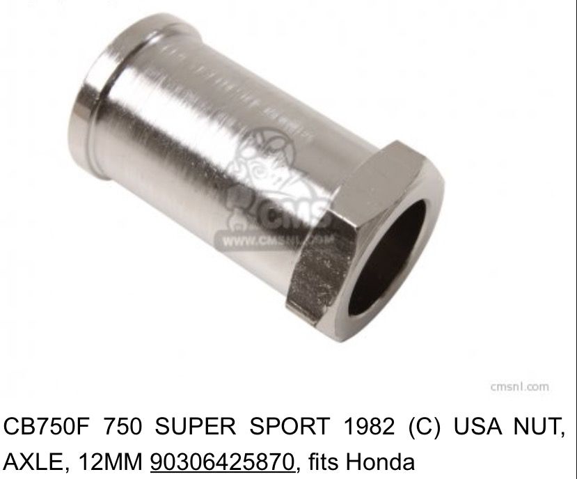

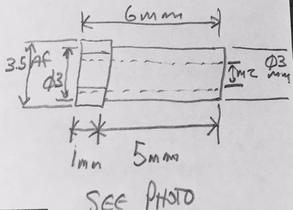

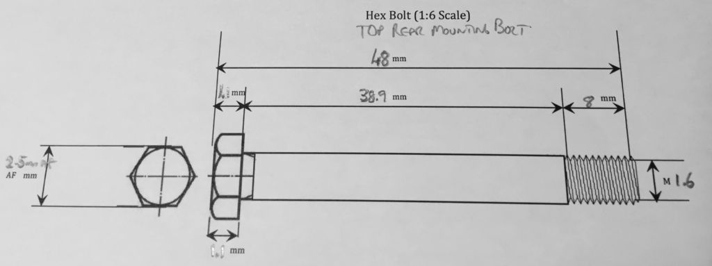

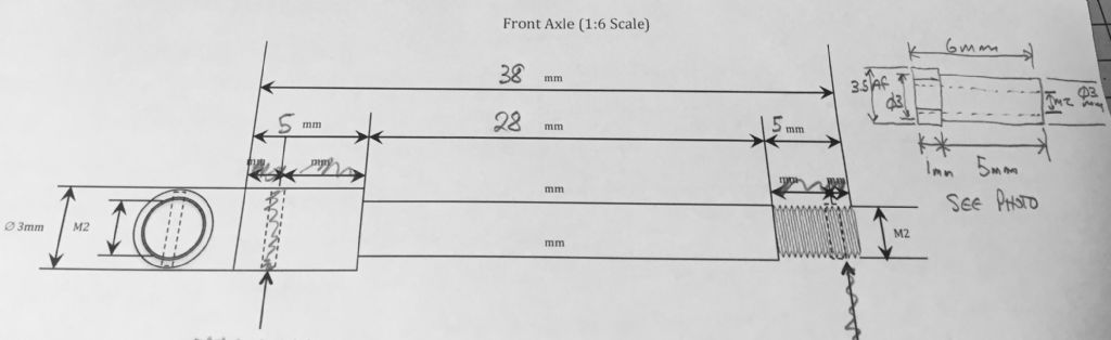

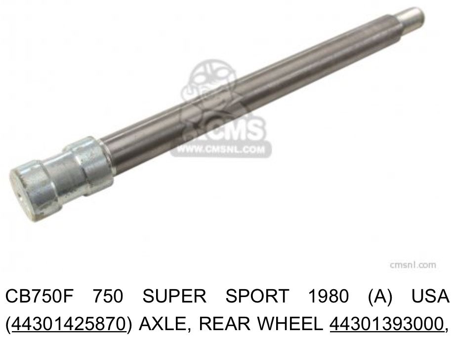

Some of the things I would like to make
Below are some parts I would like to make - An engine mounting bolt
Top rear engine mount
An axle for the front wheel plus the axle nut
1/6 front axle drawing
Front axle nut
Below are the real parts
Full size front axle
Front axle
So for my hobby it's quite small for most parts. BUT...

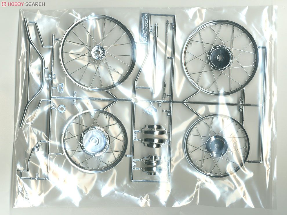

But some of the parts can be quite big. One of the problems are with wire rims, which in plastic are just terrible so I would like to turn my own rims and make a jig to make the spokes etc. The rims are typically 17" to 21" which translates to a rim with a diameter of roughly 86mm. Below are the rim halves from a 1/6 scale Yamaha Yz250 Motocross bike
Therefore I need a lathe that can handle this size of turning as the minimum starting point

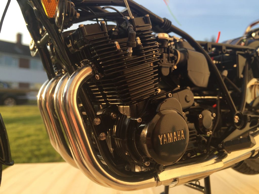

To give you an idea this is what I build
Yamaha XS1100
The chrome that you see by the way is painted on with an airbrush

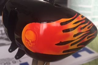

Microbike10/09/2017 22:31:20
avatar
34 forum posts
17 photos
Hello Clive no offence taken and you are of course quite right. I know from my own modelling experience of airbrushing . I have ten airbrushes in my cupboard and the one I use the most is the first Badger 200IL I bought nearly 37 years ago. It fits like a glove and does 90% of my airbrushing. I have the top of the range Badger double action airbrush that I have never actually used. The chrome finish is only possible with a Holbein airbrush that has a very fine needle and mists on the chrome to achieve this high shine finish. I have an Iwata airbrush that I used once and uuugh it didn't work for me but many other modellers achieve spectacular results with the same model. So I mostly use my trusyed Badger
It's the skill of the operator that produces the results and the tools/Machines help
Below is a model bike tank custom sprayed with my Badger 200 single action airbrush
